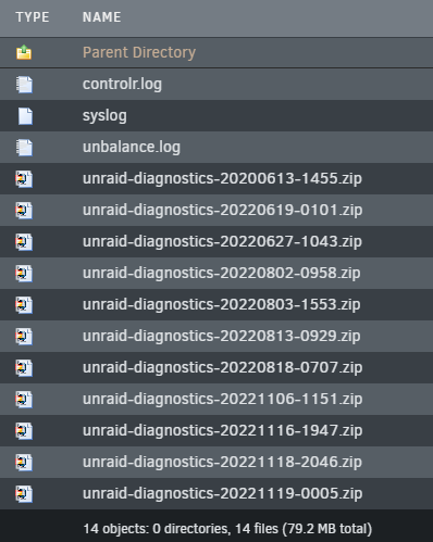

I attached the latest one... Is there a difference between these files and the ones I sent before, that came from the diagnostics tool. Also I enabled writing the syslog to flash - would this be of any help? unraid-diagnostics-20221119-0005.zip
