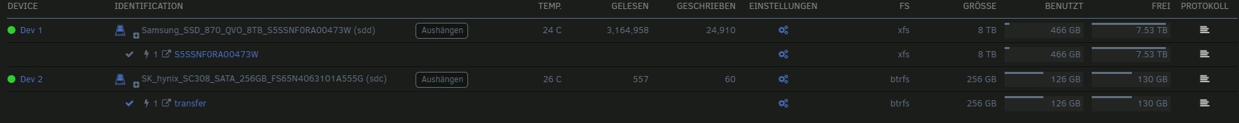

  1. Done. Debug level now it's Udev and Hotplug. Share is active. server2-diagnostics-20230220-1618.zip

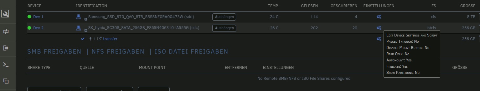

  2. That's the strange thing, sharing is enabled. Here in the screenshot you can see it.
  3. thanks, added diagnostics server2-diagnostics-20230220-1416.zip
  4. By the way, I have same problem. Until now I have been working with the shares, suddenly the two shares are no longer visible over the network. They are mounted, because I can access them internally, but not externally over the network. Load smb config files from /etc/samba/smb.conf lpcfg_do_global_parameter: WARNING: The "null passwords" option is deprecated Loaded services file OK. Weak crypto is allowed by GnuTLS (e.g. NTLM as a compatibility fallback) Server role: ROLE_STANDALONE # Global parameters [global] disable spoolss = Yes load printers = No logging = syslog@0 map to guest = Bad User max open files = 40960 multicast dns register = No ntlm auth = ntlmv1-permitted null passwords = Yes os level = 100 passdb backend = smbpasswd printcap name = /dev/null security = USER server min protocol = NT1 server multi channel support = No server string = Praxis show add printer wizard = No smb1 unix extensions = No workgroup = PRAXISNETZ fruit:nfs_aces = No idmap config * : range = 3000-7999 idmap config * : backend = tdb acl allow execute always = Yes aio read size = 0 aio write size = 0 create mask = 0777 directory mask = 0777 hide dot files = No include = /etc/samba/smb-shares.conf invalid users = root map archive = No map readonly = yes use sendfile = Yes wide links = Yes [flash] browseable = No comment = Unraid OS boot device force user = root path = /boot valid users = knv write list = knv [Backup-VM] guest ok = Yes path = /mnt/user/Backup-VM read only = No [Backup-data] guest ok = Yes path = /mnt/user/Backup-data read only = No
