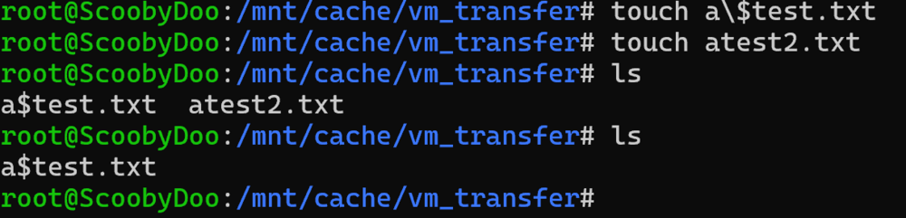

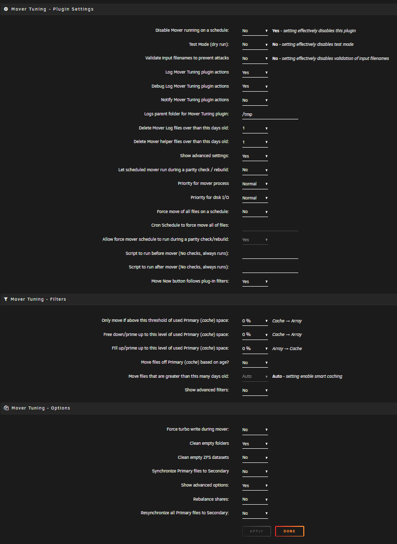

  2. I understand which threshold you mean now, though I don't understand why it needs to be 10%. I'd like it to move any files on my cache to my array, even if it only takes up 1% of the cache so that they will be protected by parity. However, I did set the moving threshold to 10% and ran it again (with the cache >10% full) with the same files as in my above post and got the same results. I don't believe I have an override dir in my plugin config. I've attached my config file but looking at it I don't see anything like that. Wouldn't the fact that all my files are moving as expected except those with special characters filtered by the 'validate input filenames' setting imply that the issue is with those special characters? ca.mover.tuning.cfg
  3. I'm sorry I don't understand what you mean by this. What overrides? Also is it the 'Fill up/prime up to this level of used Primary (cache) space' setting you are referring to? I wouldn't think that would matter as the share I am testing with is 'cache -> array'. I tested it again changing that setting to 10% as you can see in the screenshot below, but otherwise using the same settings as above. I used 5MB files this time. I also reinstalled the plugin for good measure. The commands are included in a screenshot below, and I list the files before and after running the mover. I also attached the logs from this most recent test. Mover_action_2025-04-23T023816.list Mover_tuning_2025-04-23T023816.log Debug_Mover_tuning_2025-04-23T023816.log Filtered_files_2025-04-23T023816.list
  4. correct Attached: - Screenshot of my settings - Screenshot of me creating the test files and listing the files before and after the mover is run - Requested log files Filtered_files_2025-04-22T112656.list Mover_tuning_2025-04-22T112656.log Debug_Mover_tuning_2025-04-22T112656.log
  5. What setting are you referring to? Is it 'Free down/prime up to this level of used Primary (cache) space'? If so that is set to 0%. As far as I can tell I have no filters enabled, all files should be moved each run.
  6. I'm having an issue transferring files with the characters filtered by the 'Validate input filenames to prevent attacks' setting, such as '$', despite the setting being off/set to 'no'. For example, I have a file, 'a$test.mkv' and again 'Validate input filenames to prevent attacks' is set to 'no'. However, when I run the mover it does not move and it still shows up on the filtered_files list in the log. Any idea why this is happening?
