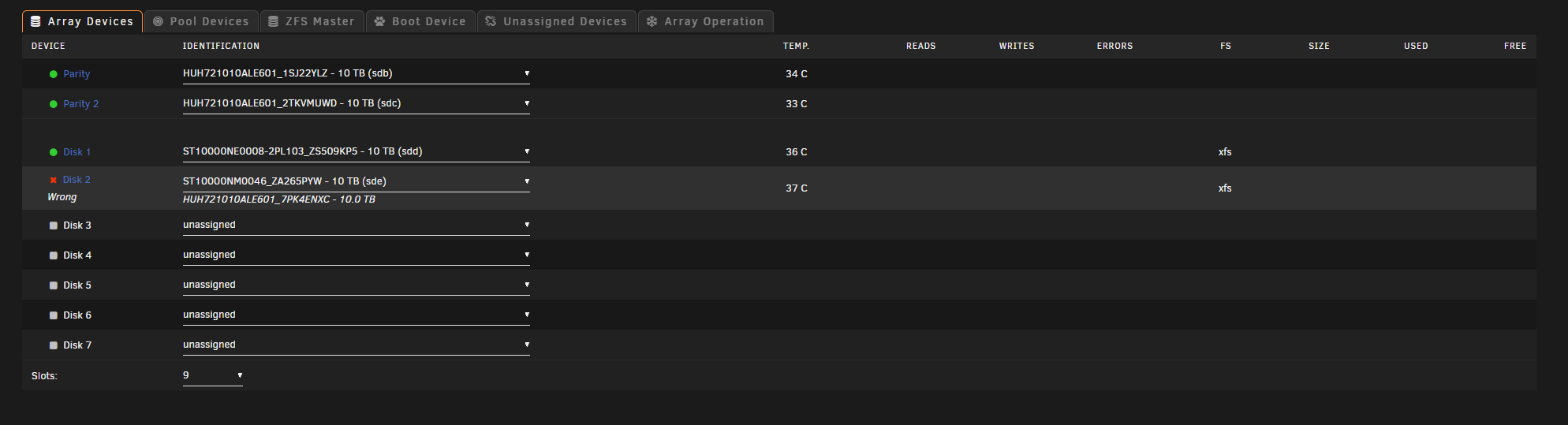

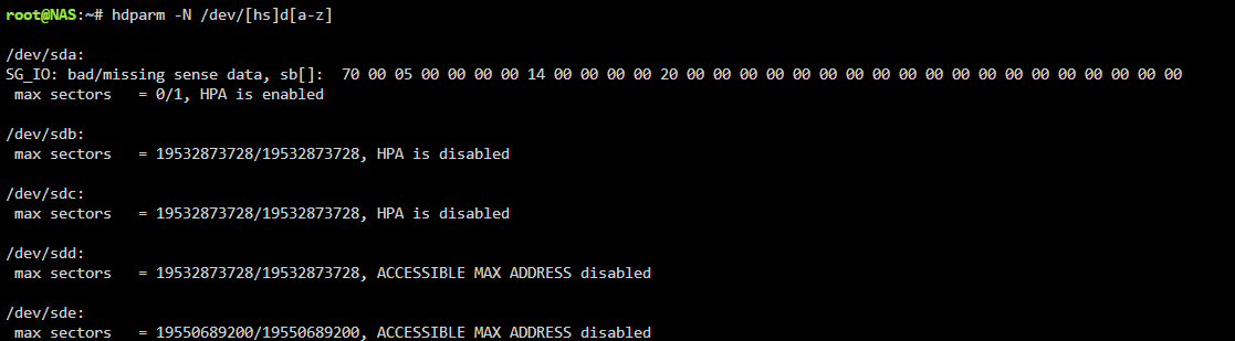

Can not make a 10TB drive swap with a 10TB drive. Disk in parity slot is not biggest.
Thank you for your help! Started the copy process and it will take about 2 days to copy. I don´t understand why it takes so long to copy 10TB but it is good that there is a solution for this problem. After the copy process I can start the array and also the data rebuild should start.
I can not install back the failing drive because the server does not boot when it is installed. My question is is it safe to do the parity swap? Also does it work if only one parity drive is bigger afterwards?
I see that it is a little bigger buit is there something i can do?
- Can not make a 10TB drive swap with a 10TB drive. Disk in parity slot is not biggest.
I had a failing disk and wanted to swap it for a precleared disk but i can not start the array any more. I get this message: Disk in parity slot is not biggest. This was the failing drive: HUH721010ALE601_7PK4ENXC - 10.0 TB This is the new drive: ST10000NM0046_ZA265PYW - 10.0 TB I did the replace data drive procedure step by step. What am I doing wrong?- VNC keyboard?
I am having the same problem... Any help? Please... - Can not make a 10TB drive swap with a 10TB drive. Disk in parity slot is not biggest.
