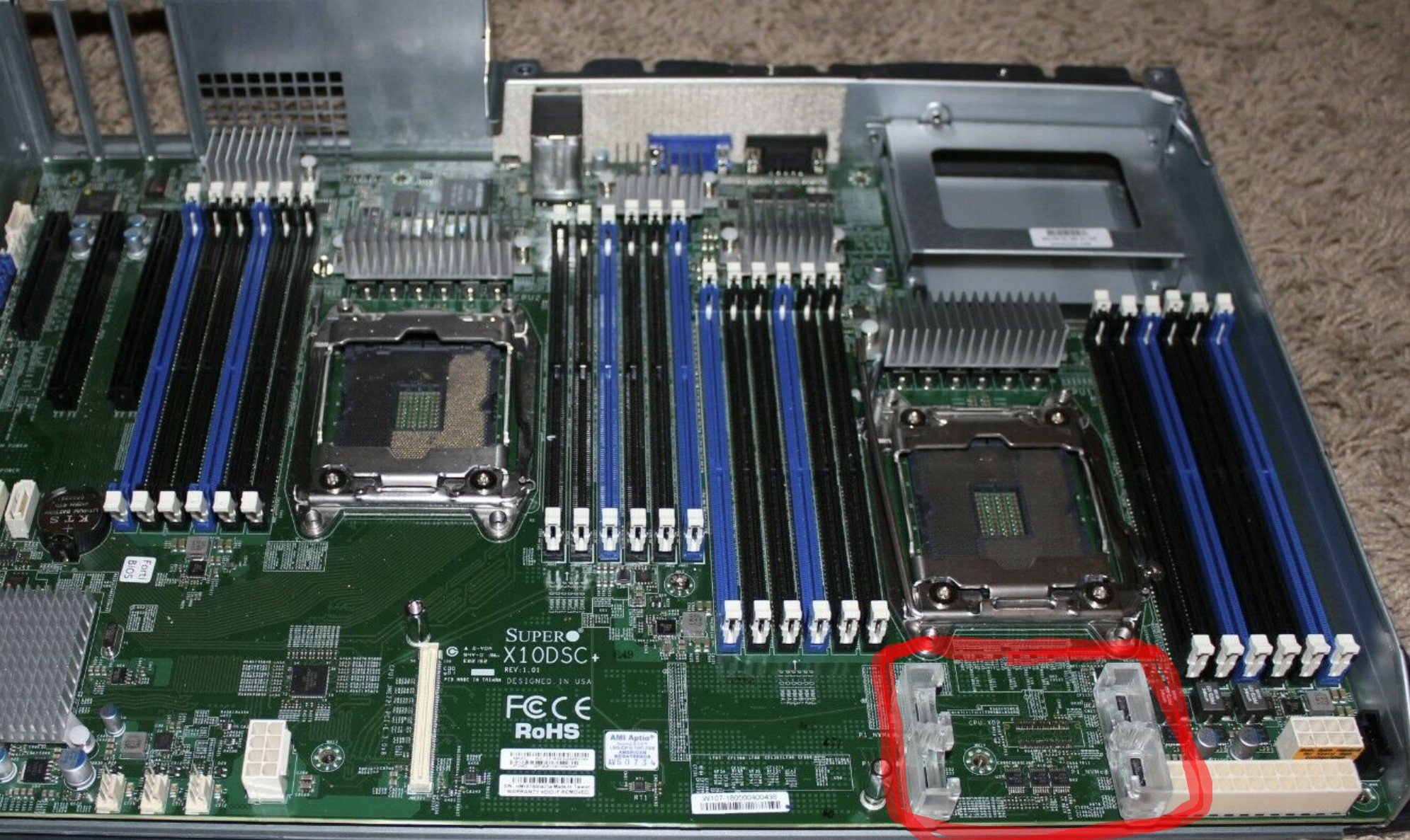

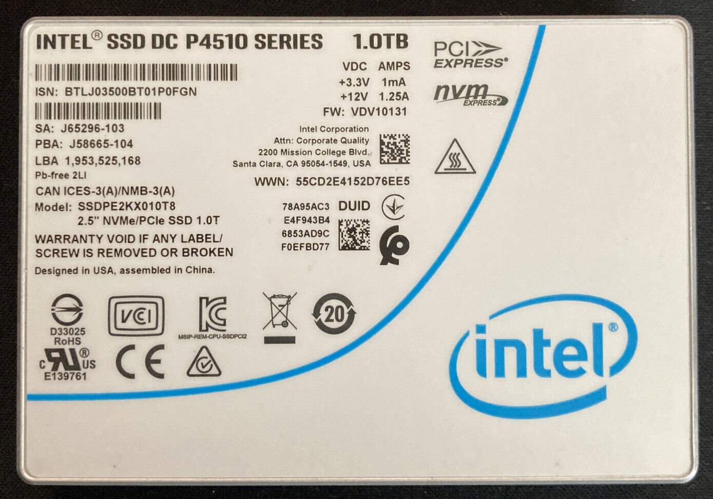

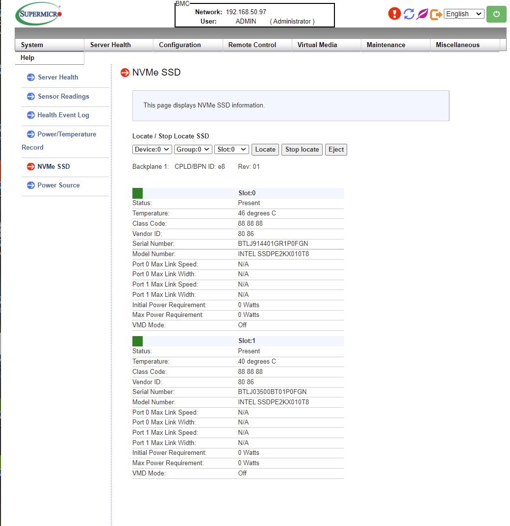

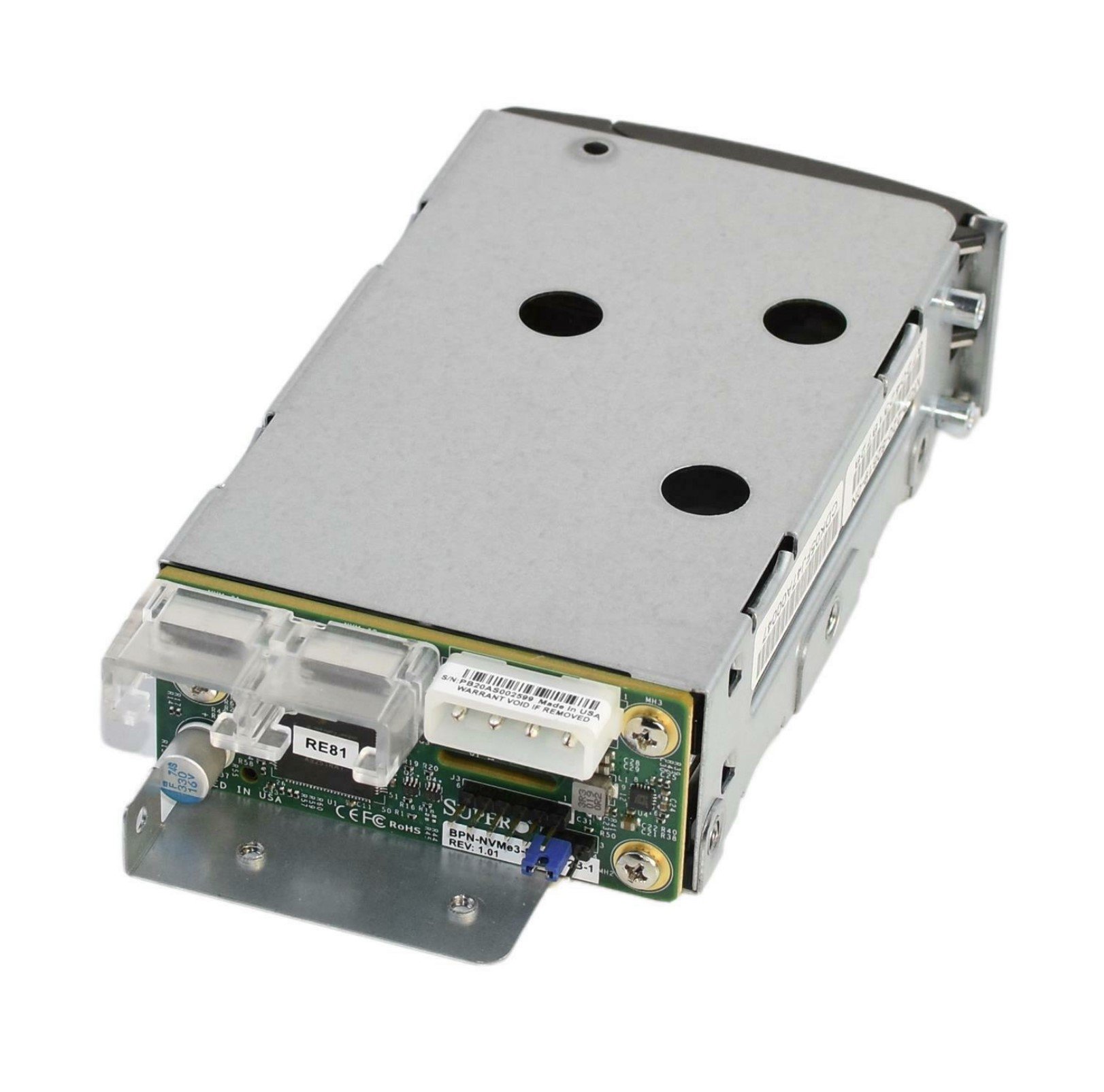

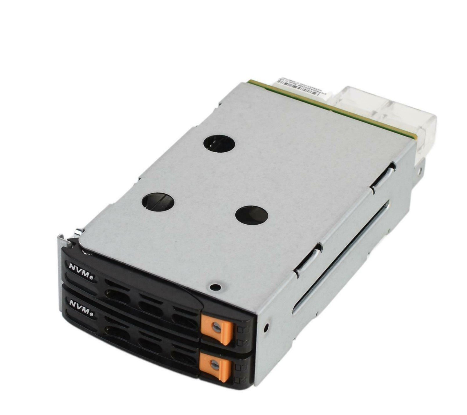

  4. I Cant locate anything specific to the NVME drives in the BIOS settings. I spent probably half an hour looking through each setting and didn't locate anything about them. I'm really at a loss of what to do? Any ideas would be appreciated...
