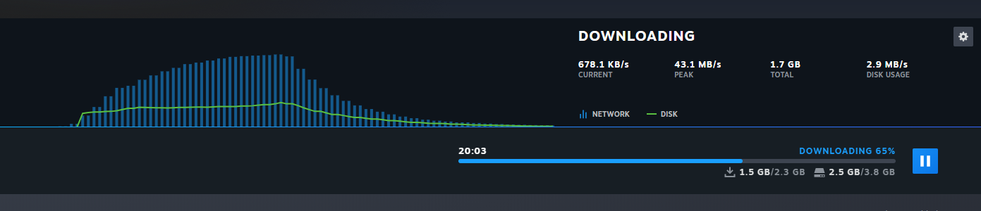

  1. So after learning about lancache i decided to install it. I got it installed and working but it only partially works. I installed Portal as a test but after uninstalling it and then redownloading i get excellent speeds until i have about 1.5gb downloaded then it seems like it switched to downloading from steam as the speed drops to wan speeds. I have it on its own separate ip address to avoid port conflicts.
