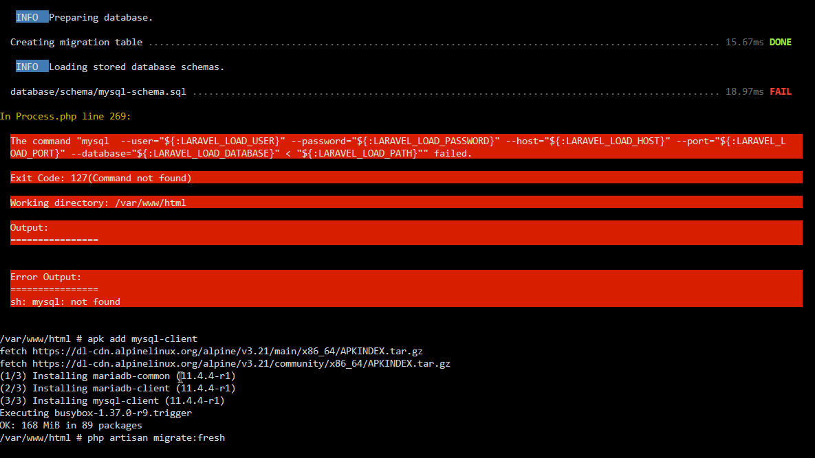

  12. Mysql-client is not installed on the container, if you can update the docker so it will stop mysql erros.
