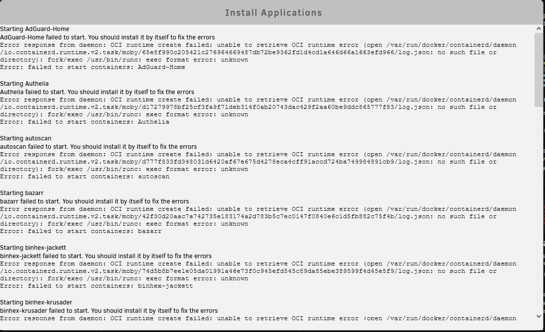

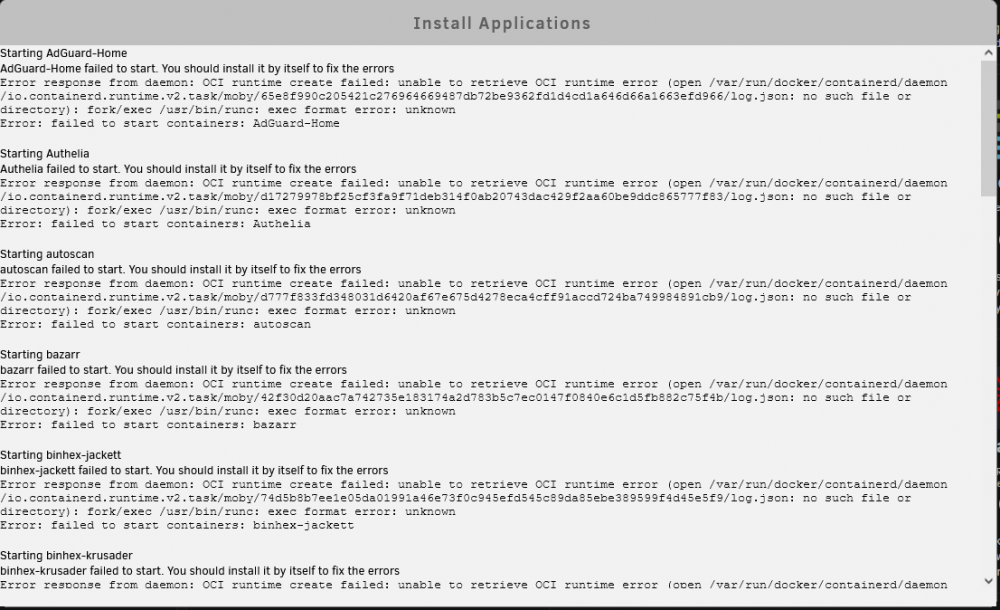

  15. So my GUI commands of start/stop and delete aren't working, what i can do to fix that, that happens after the update to the new version 6.12.x i tried everything delete all dockers and install again, new browser, server restart but nothing works tower-diagnostics-20230819-0307.zip
  16. last time i create my own docker container it took me a full week to make it work

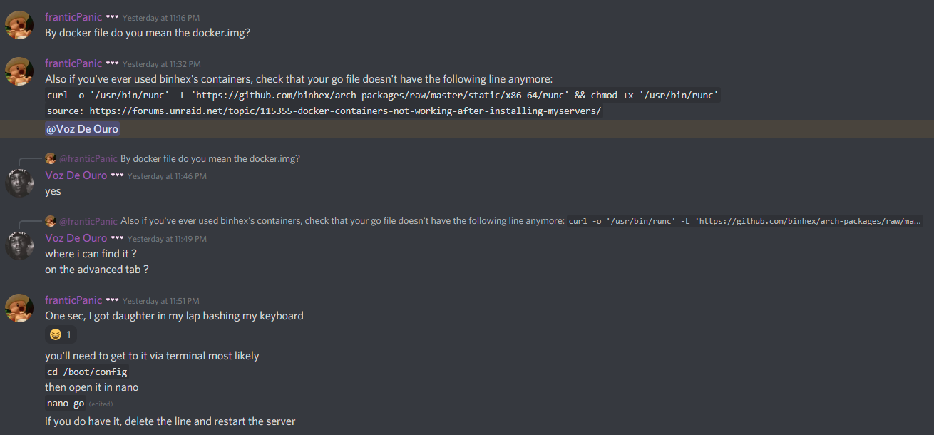

  17. i deleted the docker file and install it again but got the same error Error response from daemon: OCI runtime create failed: unable to retrieve OCI runtime error here is my log tower-diagnostics-20211128-2120.rar

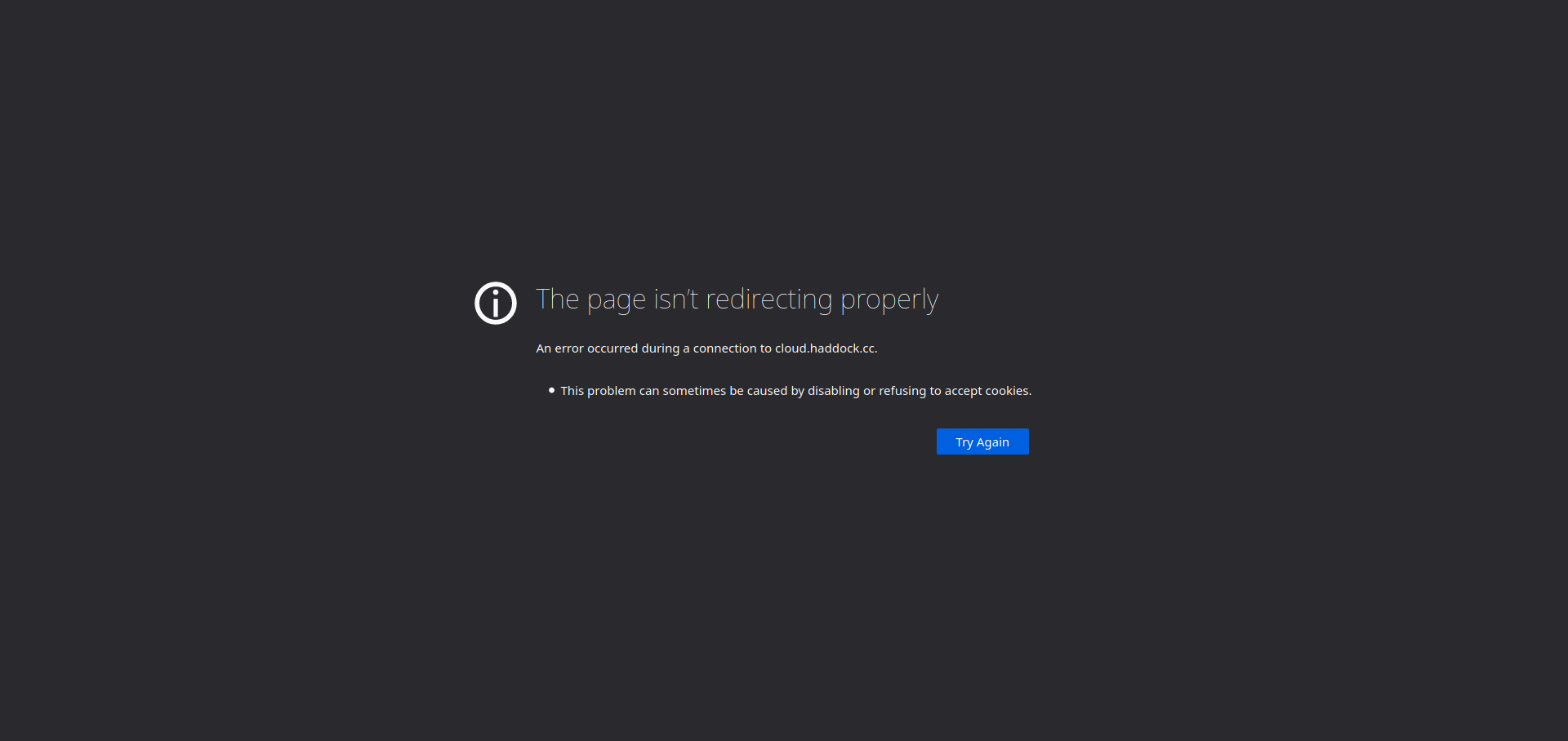

  18. can't change my domain name to my new one if i put the new domain name on the config i got this error any one knows something ?
  19. how i can check that ?
