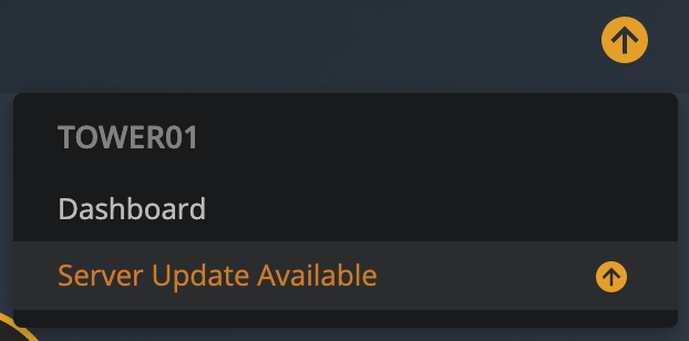

  4. Thank you, I feel very stupido I never realized such button was there lol. Clicking it made the update prompt show up, problem solved, thanks again!
  5. Hey guys, I have an alert saying there is an update to plex inside the plex web interface, it tries to make me download an RPM file, the update does not show up on unraid docker list like it used to. How do I go about updating plex? Thank you!
