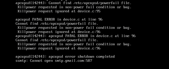

  1. I'm having the same issue. I haven't had an issue when shutting down from the web interface. However after a power failure my Unraid box would not shutdown properly and required a parity check. Recently I tested a shutdown using the powerbutton and it hung on the error as per this photo. Hitting the power button after waiting a while shutdown successfully. Leaving this comment here in hope someone can provide a solution at some point.
