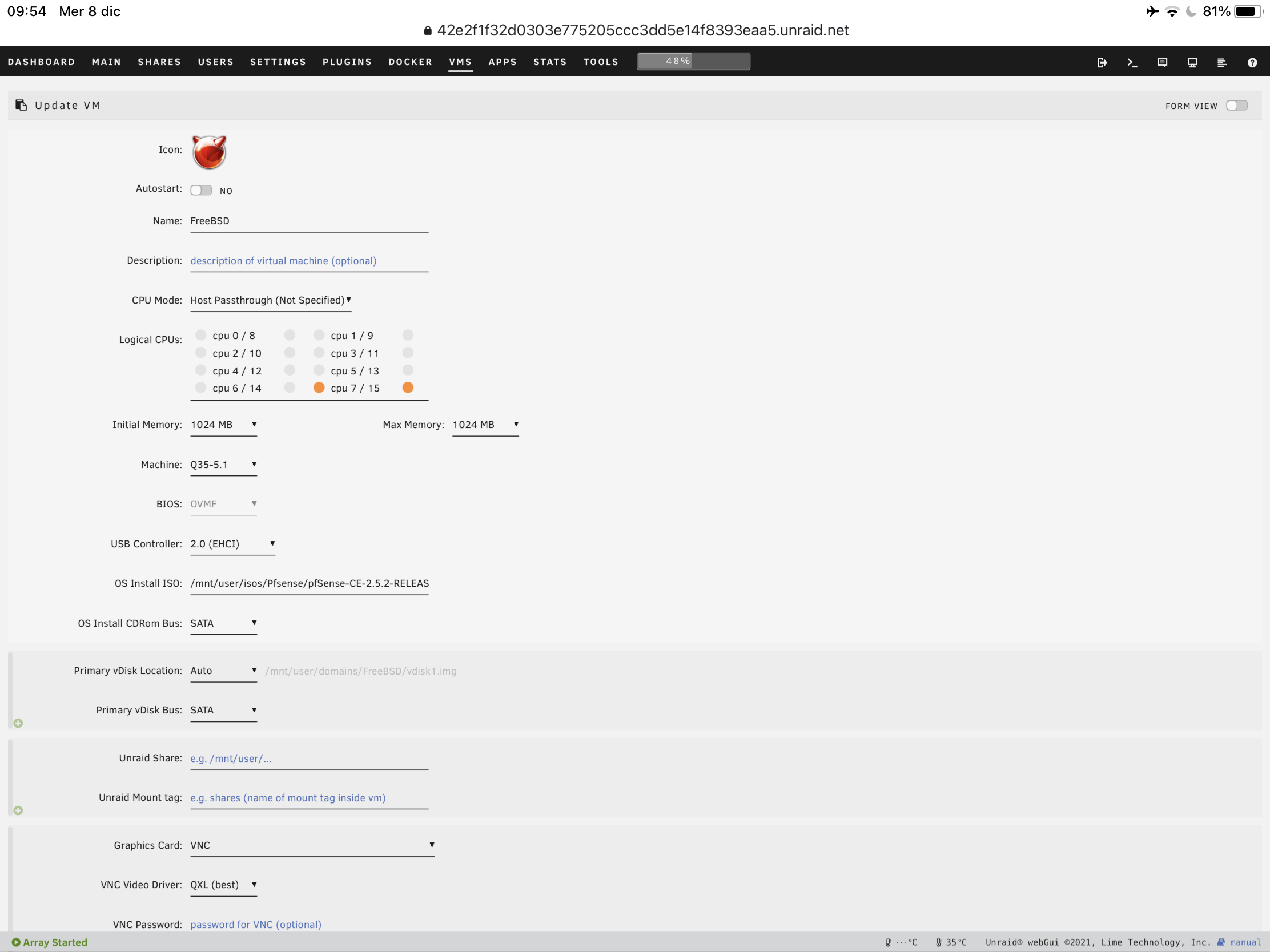

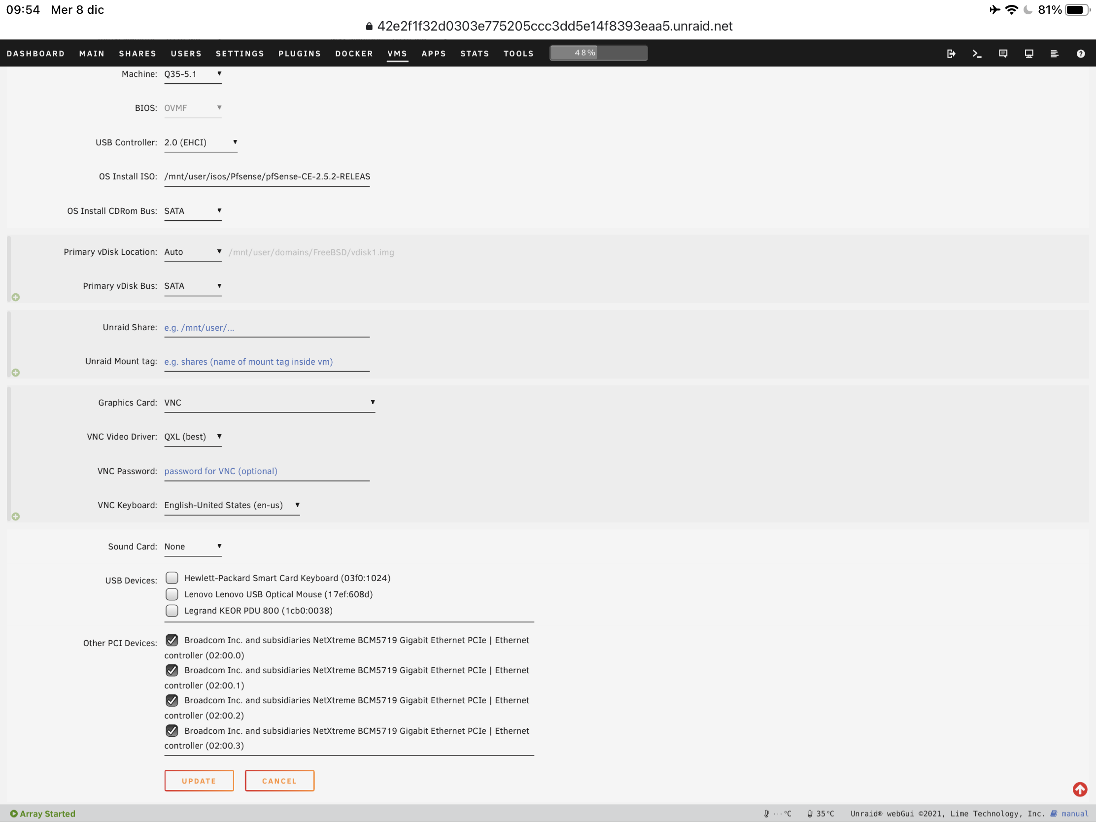

  7. Hello I tried in legacy but it does not find the internal Usb, so no Boot. I don’t get why the server reboots as soon as i hit start on the pfsense Vm. Kernel Panic? I don’t find any clue in the diagnostics

  9. Hello, i tried using virtual adapter, without passtrough and the pfsense Vm booted up but then hangs since it finds no nic cards, just to see if the installer was valid. I’m booting in uefi mode. i found a rom firmware p92-2.72. From 2019, my bios is from 2015, might it be the rmrr issue was addressed? thanks in advance

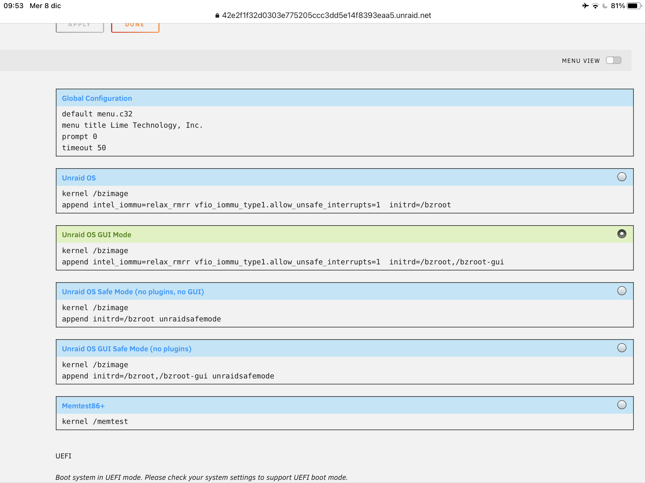

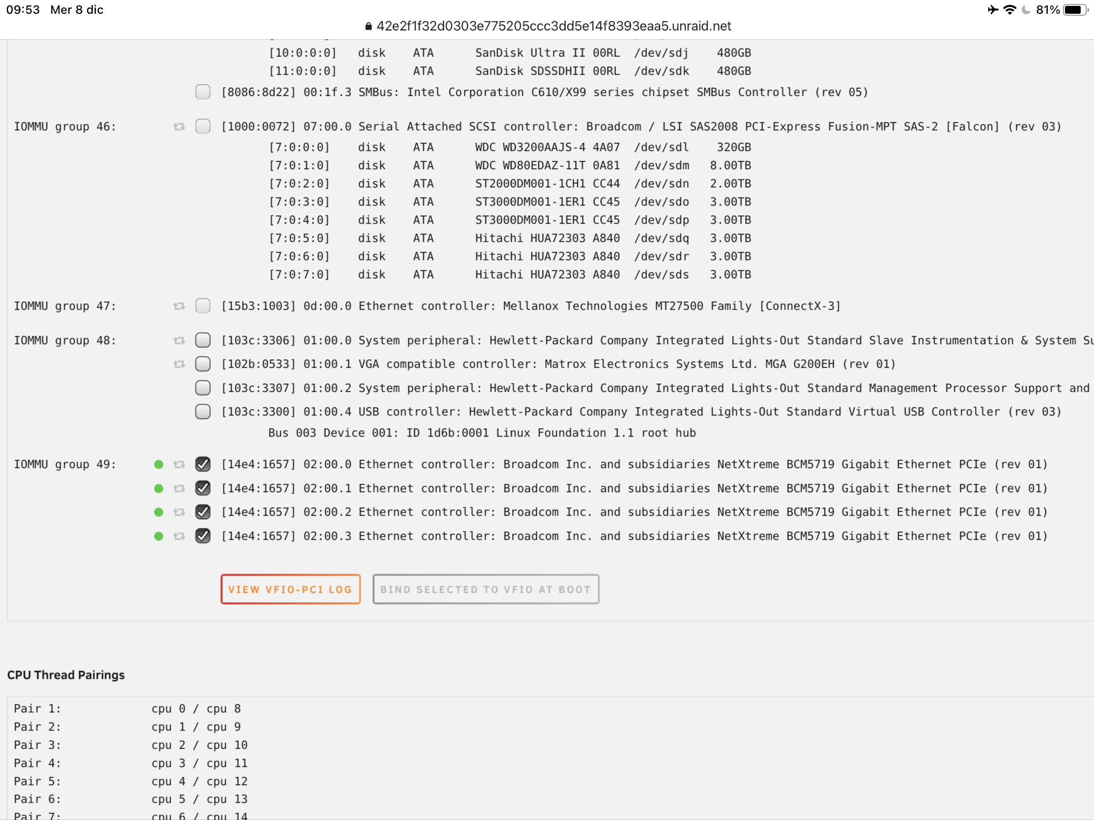

  12. Hello all, I’m coming back on the hardware passthrough problem since I’m having a wierd issue. I’m running unraid pro 6.9.2 on an Hp Ml350 with 16disks installed. Bios P92 (2015) out of warranty and not upgradeable anymore. 10Gbe mellanox card as the only ethernet connction in use. Two Vm are up and running reasonably stable. I have the integrated quad nic not in use at the moment, the four nic are located in the same IOMMU group and are bonded to vfio at startup. I can’t see them in the unraid dashboard. so I tried to set up a Pfsense Vm to play with. The machine did not want to passthrough the nic card giving the “inelegible hardware error..” which is related to the rmrr issue in Hp server. I then pathed the image and added ‘intel_iommu=relax_rmrr vfio_iommu_type1.allow_unsafe_interrupts=1” to the flash. Grep command says rmrr are relaxable, so I assumed the patch worked. when I set up the Pfsense vm I check the broadcom cards (NetXtreme BCM5719) to pass through, I removed the virtual network adapter. As soon as I start the Vm to begin with installation the whole system hangs, crashes and reboots with parity check and the VM tab in dashboard not enabled. If don’t passthrough the nic card, just virtual nic adapter, the pfsense install starts normally without issue. Any help would be welcome, I’m posting my log file and some screen shots thanks in advance homeserver-syslog-20211208-0857.zip
