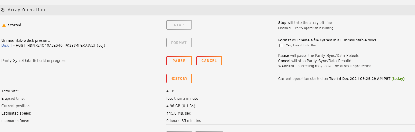

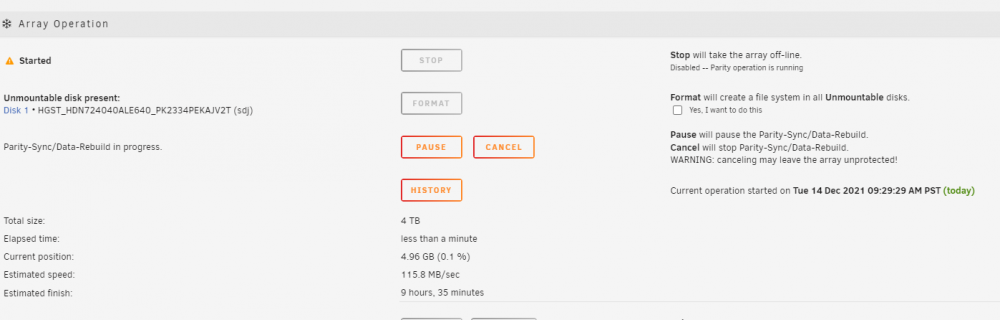

  4. thank you i just read that so im glad i didnt LOL i am letting it rebuild as we speak and just let it do its thing thank you so very much for the help today as always until next time i mess up
  5. im guessing i need to format and let it rebuild???

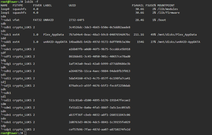

  10. sounds like perhaps if i make the other drive mountable again then perhaps i might be able to recover it??
  11. when i run the command lsblk i can still see its encrypted correctly like the rest of my drives so i would guess the SDK1 would be my parity for its not encrypted
