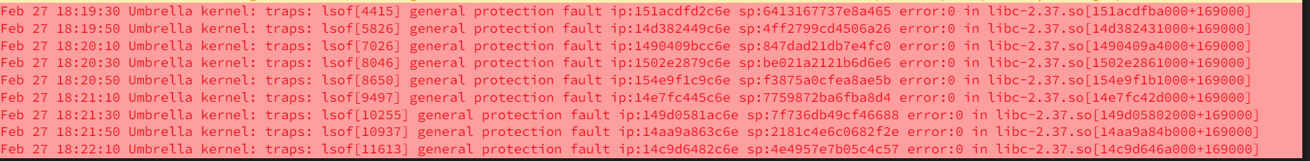

im using macvlan without bridging and host access to custom networks on...it isnt right? also what the heck is this???- Unraid OS version 6.12.8 available

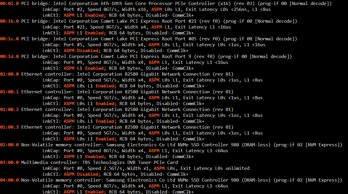

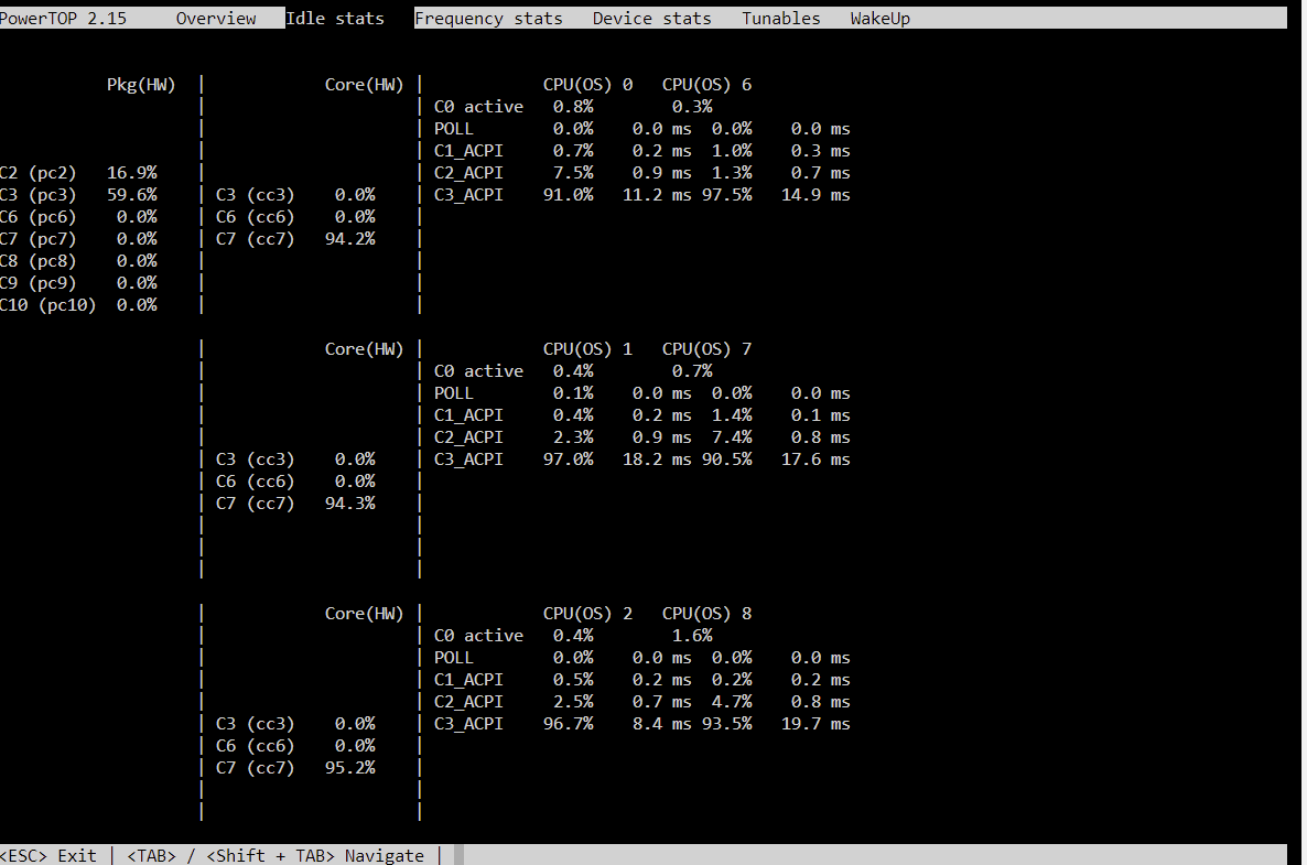

hello, sys specs Asrock B460M i5-10400 32GB Crucial Pro 3x 12tb disks 2x 980 pro nvme cache 3 dockers 1 vm with everything spun up i was running 55-60w, thanks to mgutt i made all necessary bios settings: no turbo, cpu page: max c states all enabled (LO , L1), pcie page: all enabled ASPM etc etc, installed powertop and spun down disks and im getting about 35w but i have some problems not going below c3. plus i have a problem with my TBS 6281SE it supports L0 but it doesnt activate at all...plus i tested without it and getting the same c3..one last thing if i run a simple win vm then no c states!!???- Unraid OS version 6.12.6 available
