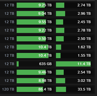

  2. Array has rebuild "successfully". However, i still lost over 8TB of data from that drive. it only managed to recover around 600gb from rebuilding. Quite bummed about this honestly. You expect this to not happen when your parity checks were all fine and the rebuild is "succesfull"

  4. Just noticed Disk 6 till 9 are all spamming read errors in dmesg. Which is weird since these are all tested and fine.
