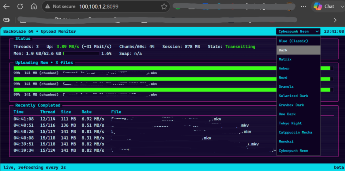

[Plugin] Backblaze64 Monitor
Thank you! I should have specified, but I know all these features will eventually be pushed into the latest build.
