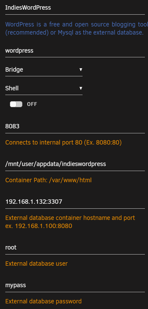

  4. Hi Kru-X, Yesterday I cleaned up everything, and tried again, this time I used an exclusive mariadb docker with a custom user and password and the database named "wordpress". I did it twice and I got it running both times, each time with a exclusive docker for both wp and db. Now I want to try make them public to the internet. Thanks for your help.
  5. I'm using CA Cleanup Appdata to clean everything between tries. I've tried creating a password in the mariadb docker and setting the root user with the password and it didn't change anything. Thanks for all your help, I'm goin to try using portainer to get this running. Thanks for your time.

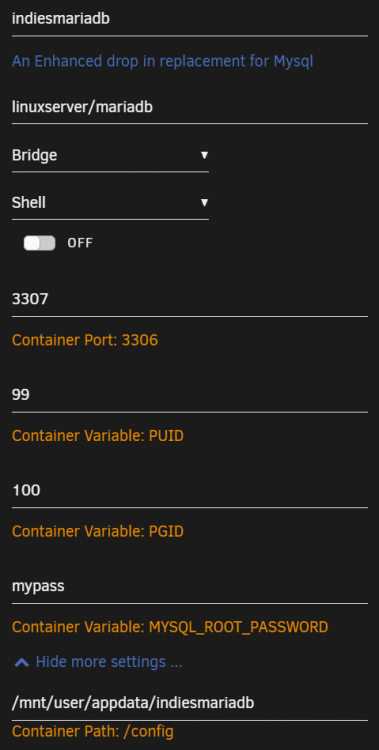

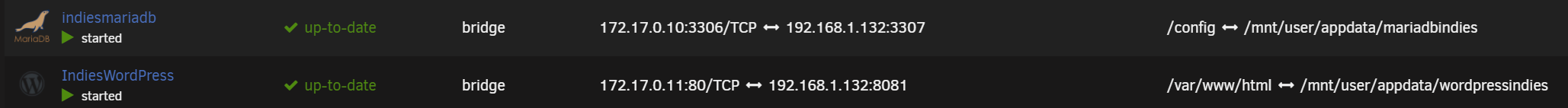

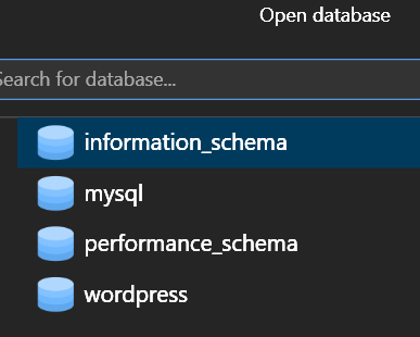

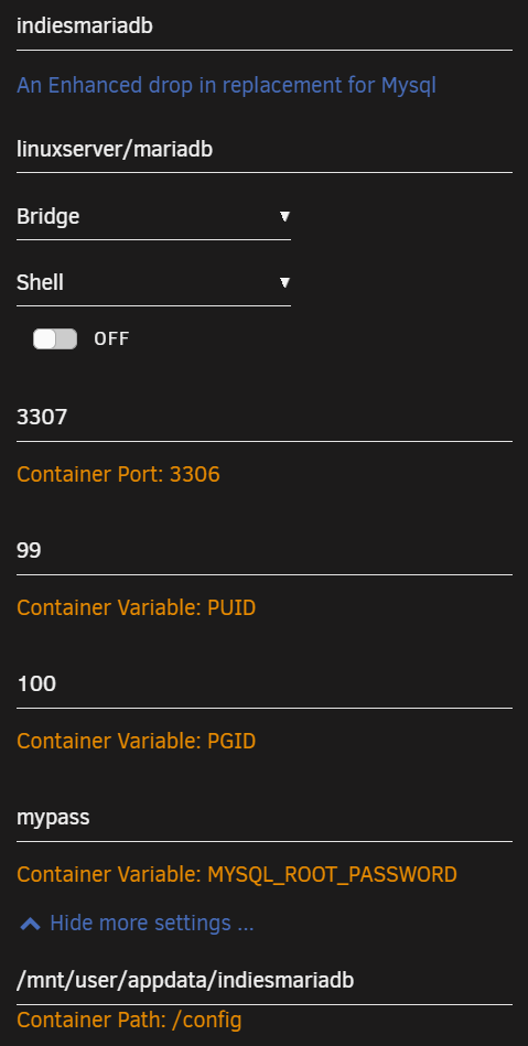

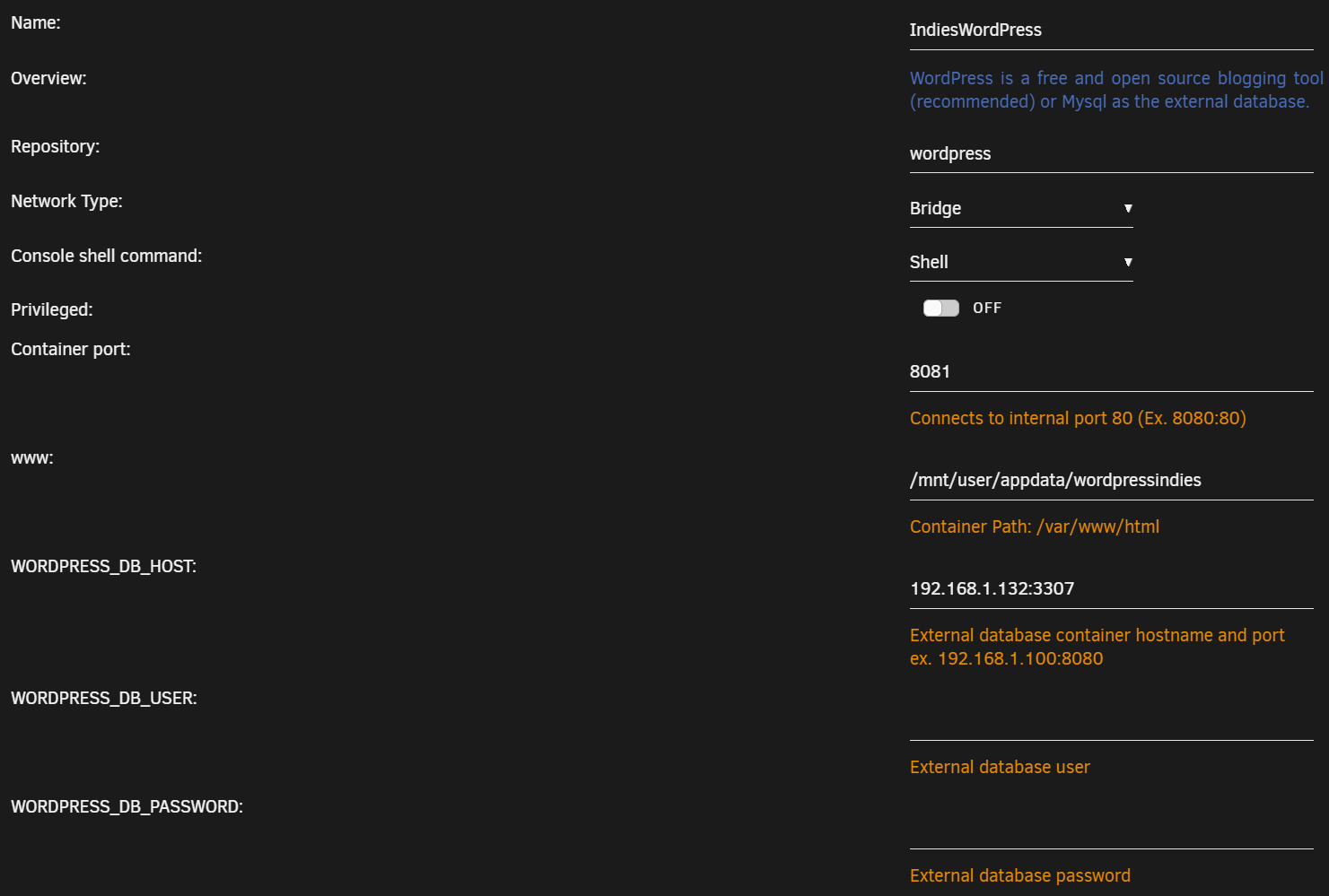

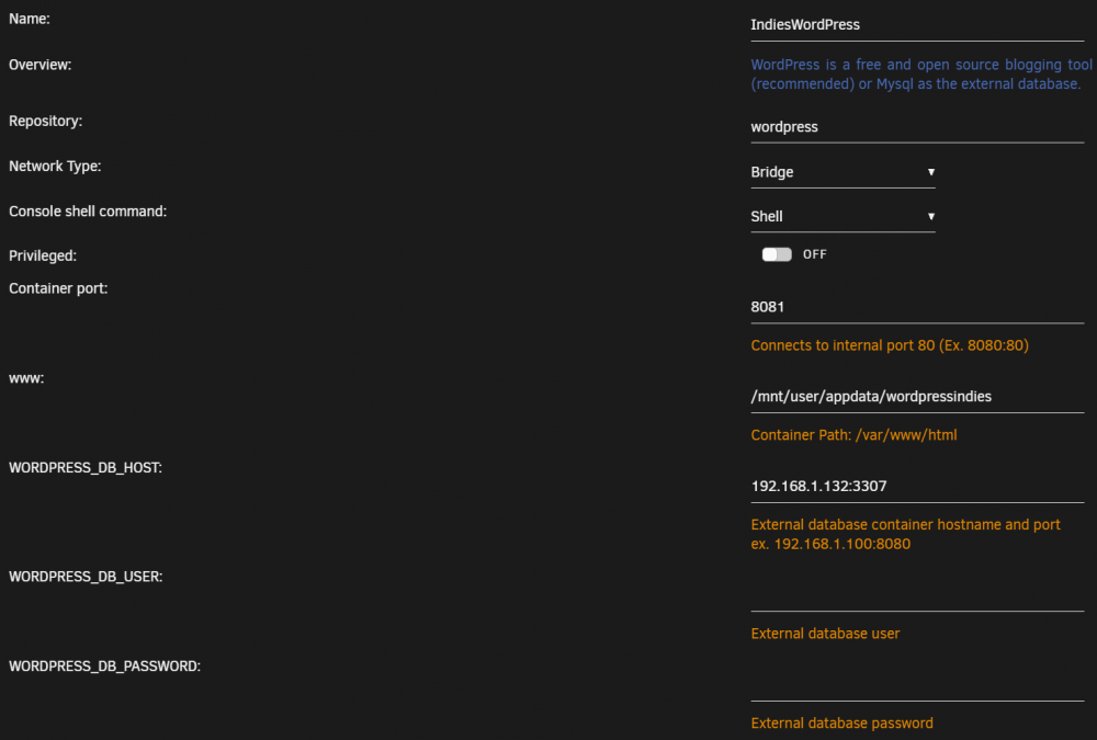

  6. Hi Sorry for my incompetence. I'll describe what I've done but I still have the DB Error. I've instaled a new mariadb instance, an left it like this: After that, I configured I tried to methods, first I mounted a new WP docker but it didn't worked. I cleaned all up and Installed again the mariadb, entered through console and create a new wordpress database, here you can see the TablePlus info: After that I created again another WP docker like this: As I said, I still have the "Error establishing a database connection". Here it is the resume form the Docker panel: I've read this thread several times, but I still can't figure out what I am doing wrong. Thanks for your help.

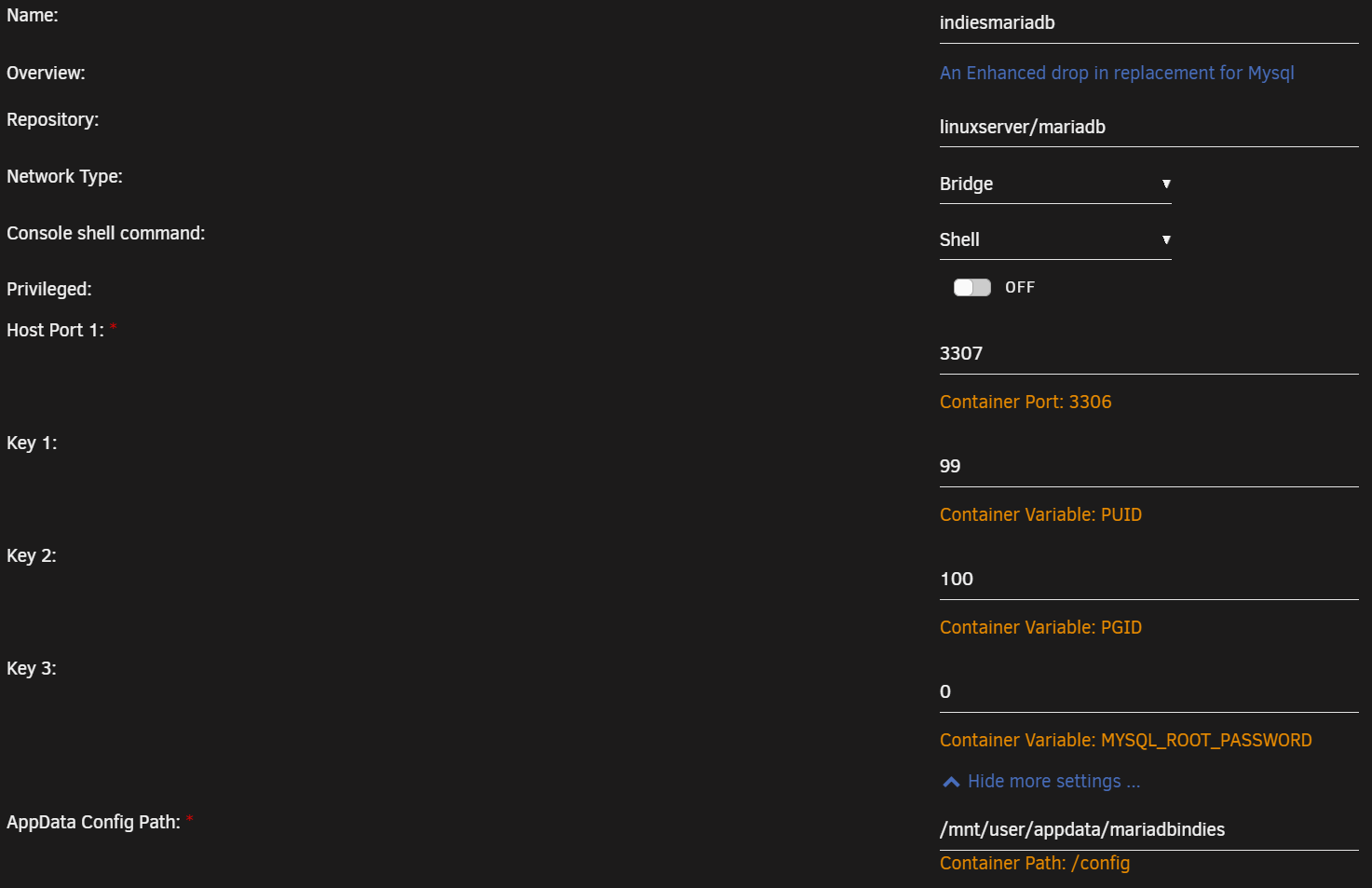

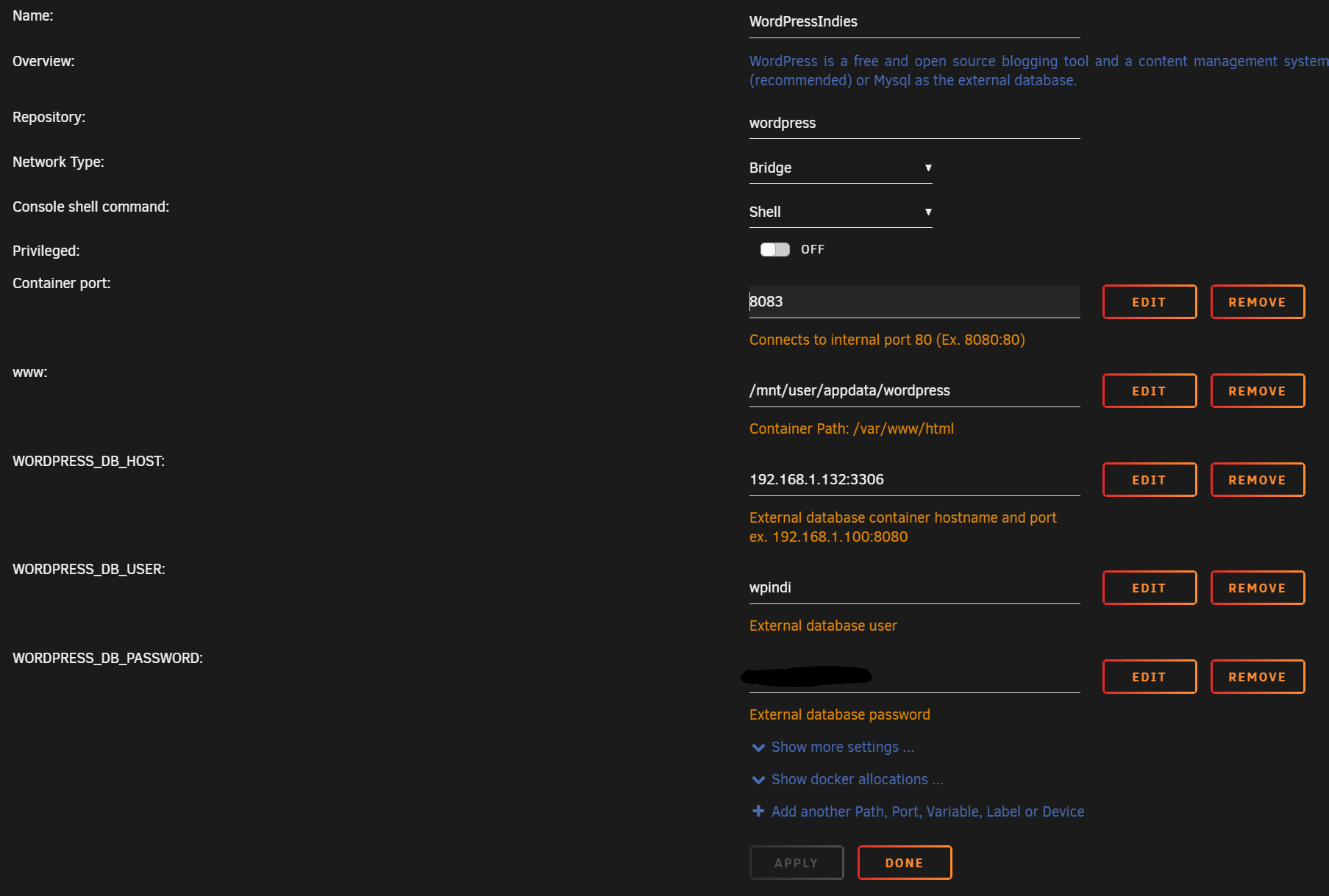

  9. Hi, I'm trying to configure this Docker with mariadb. This is my actual configuration: When I use the Docker UI button it takes me to the 8080 port, and when I change it to the one I put, I get the Database Error I've read here. I checked he wp-config.php and the wp-config-docker.php files and they don't have any info from the docker form above. When I edit them I only get an error that I need admin rights. I'm a newbie, I only have Unraid from a week or so but as I have read and watched, I think this should work. What am I doing wrong? Thanks in advance
