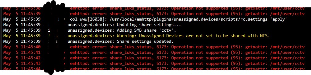

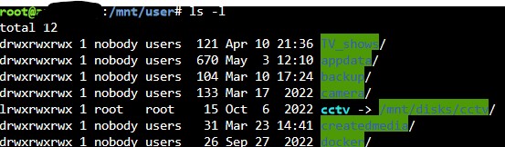

I have been getting these errors non stop in my logs for a while now. So far everything looks like its working but its related to my non-array disk i use for my Zoneminder install (cameras) May 3 16:34:22 domain emhttpd: error: share_luks_status, 6173: Operation not supported (95): getxattr: /mnt/user/cctv May 3 16:34:23 domain emhttpd: error: share_luks_status, 6173: Operation not supported (95): getxattr: /mnt/user/cctv May 3 16:34:24 domain emhttpd: error: share_luks_status, 6173: Operation not supported (95): getxattr: /mnt/user/cctv May 3 16:34:25 domain emhttpd: error: share_luks_status, 6173: Operation not supported (95): getxattr: /mnt/user/cctv May 3 16:34:26 domain emhttpd: error: share_luks_status, 6173: Operation not supported (95): getxattr: /mnt/user/cctv May 3 16:34:28 domain emhttpd: error: share_luks_status, 6173: Operation not supported (95): getxattr: /mnt/user/cctv May 3 16:34:29 domain emhttpd: error: share_luks_status, 6173: Operation not supported (95): getxattr: /mnt/user/cctv Note i replaced my server name with "domain". I have the drive set up like this the following screen shots. I received this comment in the general support thread: The problem is i'm not clear on this. SMB sharing is on (screenshot of that being turned on in the logs). Its also been suggested something else is using that share but theres nothing on there but i dont know what it would be. Only camera footage is on there. Any ideas?
Constant errors: "emhttpd: error: share_luks_status, 6173: Operation not supported (95): getxattr:"
Okay i did that but it had no affect. I'll have to post over there to see exactly what i should be doing, because i think i've checked everything, short of adding code to smb-extras.

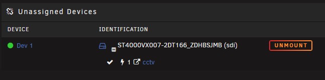

Okay! So thats a start, and makes sense.. But i'm not clear on how it should be configured.. So I looked at unassigned devices for both the drive and the share and sharing is on: Or if i do the smb-extras, something like this would suffice? path = /mnt/disks/cctv comment =
- Constant errors: "emhttpd: error: share_luks_status, 6173: Operation not supported (95): getxattr:"

Its only intentional as I wanted to keep the data drive for Zoneminder off the array, due to all the constant writes. I'm assuming I should not have set it up this way? Its running fine but the errors wont stop flooding the logs.- Constant errors: "emhttpd: error: share_luks_status, 6173: Operation not supported (95): getxattr:"
