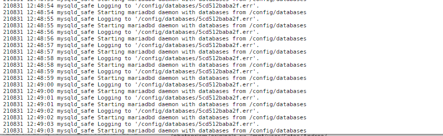

  2. Hi, I have already updated nextcloud docker and after that ,it gives me the following message: Internal Server Error The server encountered an internal error and was unable to complete your request. Please contact the server administrator if this error reappears multiple times, please include the technical details below in your report. More details can be found in the server log. Someone knows what can I do? Thank you Edit: Looking at MariaDB Log: I am also using other mariadb containers with photoprism in same version than this without issues.
