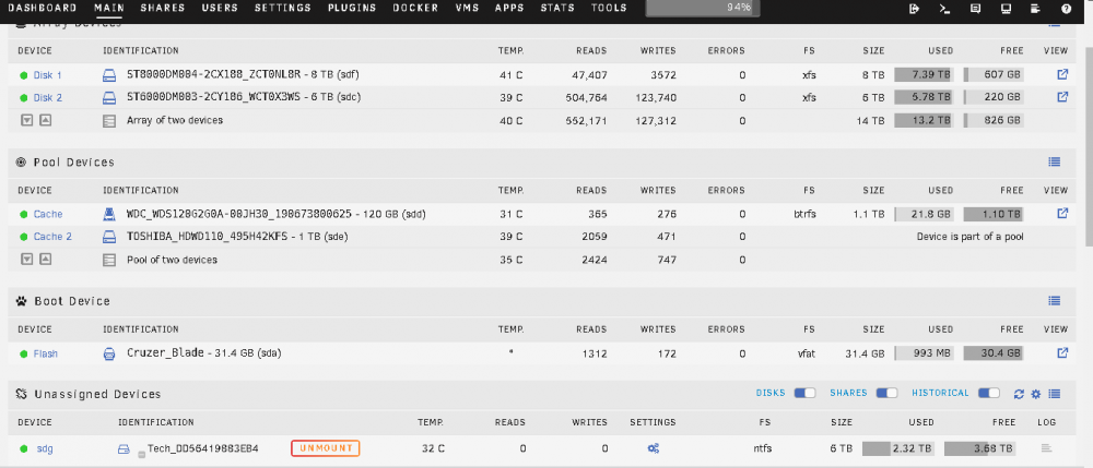

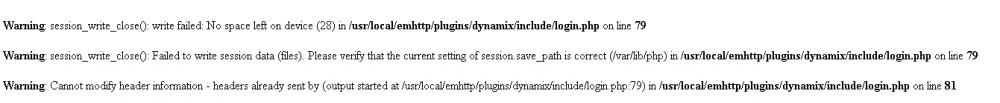

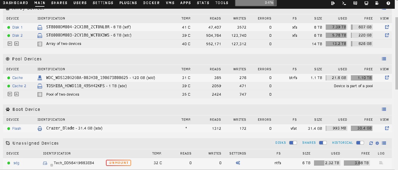

(SOLVED) No space left on device (28)
Thanks I did check the dockers and all the volumes were correct but I left my server alone for 1 day and the disk didn't fill up again so I don't know what happened. I'll sort out the shares when I get time.
The last time I set these shares to only use Cache my 1TB cache pool filled up fast and the server was unusable
Is it possible to see what caused it because my server was fine since I built it. I haven't made any changes to it in 2 months
This is the second time today I recieved this message, I'm not sure what is causing it and resolves itself after rebooting. Attached is the diagnostics (after reboot), error when trying to login and df -h output (before reboot). When this happens I can still use SSH and Plex but I can't login / access SMB shares unraid-server-diagnostics-20210920-1552.zip
