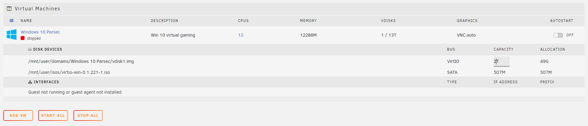

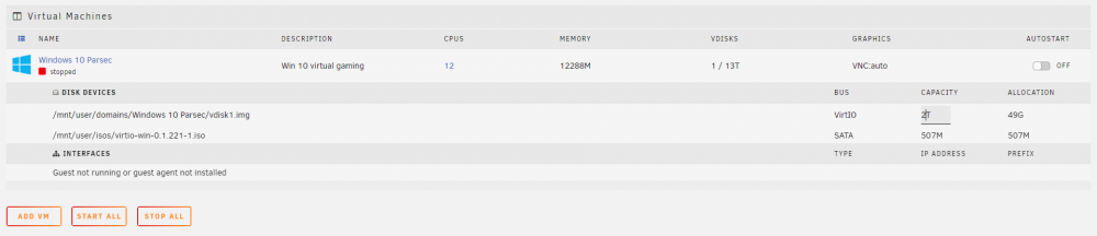

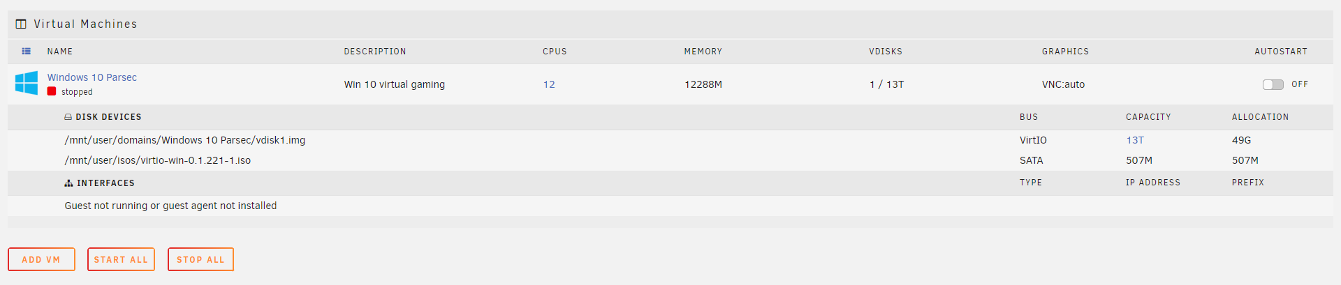

  10. Pretty weird issue. Tried to allocate more space to my win 10 VM by changing the number. Wanted a bit more and is now stuck on 13T, which is a bit steep. No matter what I try, it falls back to 13T when I hit enter
