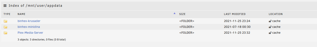

  4. @trurl thank you for taking the time and help me i now have a better understanding on how to install docker containers, what you said makes total sense did exactly what you sugested and my problem is now solved, my hard drives now spin down and stay that way. some considerations to help the comunity: mover didn't moved all the files, some files where left in the array, small ones. so i uninstaled all the dockers and used the "Appdata Cleanup - Andrew Zawadzki" app to remove them completly from my system. I changed the "appdata" and "system" shares options to "Use cache pool (for new files/directories): Prefer" Installed the dockers again, they went straight to the Cache drive. only bummer was Plex, it had to rebuild all the metadata a lost my stats. once again thak you very much.
