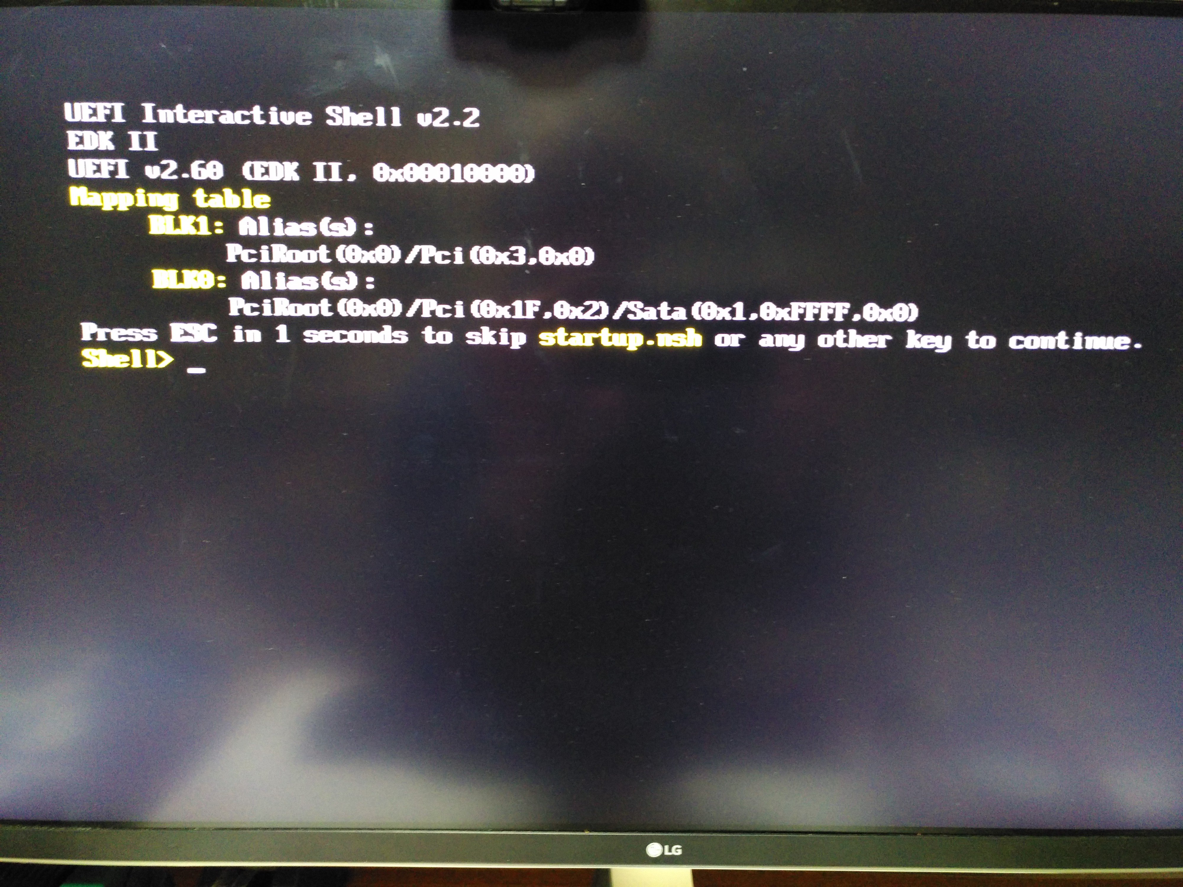

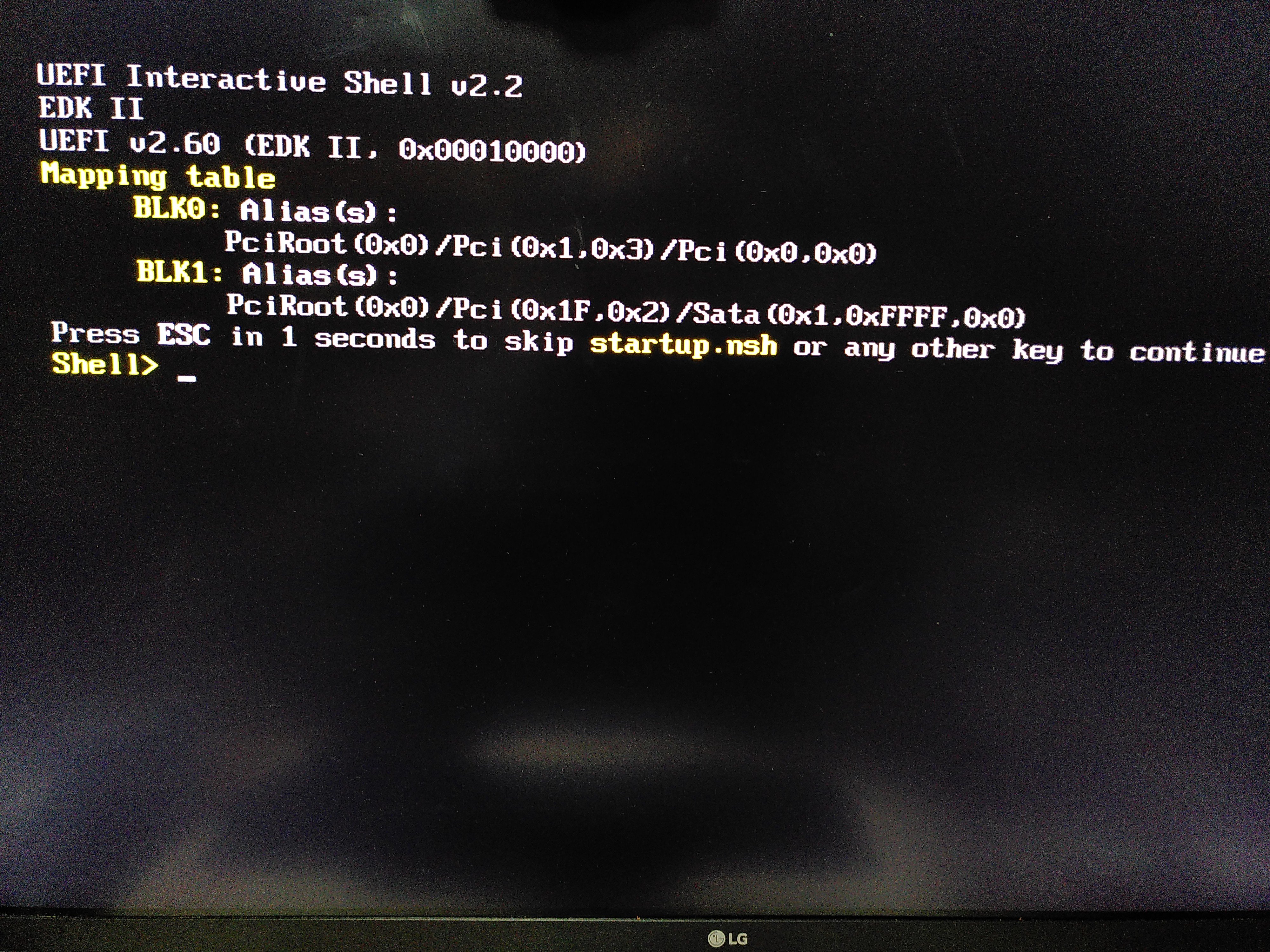

  14. Ok, looks still the same.... I installed windows with OVMF in the VM-template, as machine I used Q35-5.1, vDisk bus is VirtIO. My other Win10-VM, which uses the same vDisk, but as graphic-card VNC, is still working.
