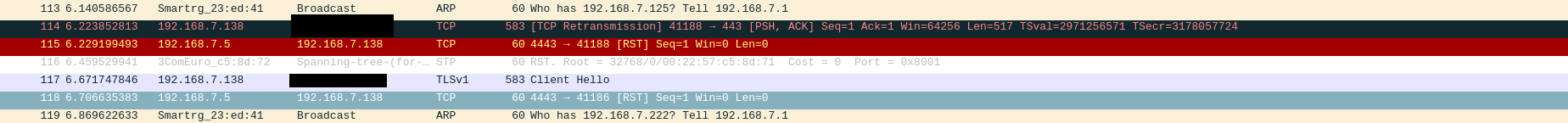

  6. Hi Mikey, I am pretty new as well but can try to help. I am not sure on the port 8083, I tried 8038 which yielded same results. Monitoring traffic on wireshark, my PC sends the request to server + port and the server replies back with a RST (reset) flag. I have influx running on a custom network so there may be an issue on the custom network port 8083 that port 8038 forwards to. I probably won't dive deeper, time is limited between work and farm and port 8068 works for now I just downloaded Grafana today so I can start playing around with it. I have Telegraf and Influx working. Have you been able to get into influx with the second port?

  10. So I tried that forwarding to port 444 in NPM, tired HTTP only then HTTPS (all without certificate) and the server just sends RST every time. So I went ahead and swapped the ISP router with my personal linksys router and I now can access valutwarden through my domain! I tried nextcloud, had some issues but I need to re-configure it back to square 1 but I am out of time and need to leave for work. It appears that the ISP router was blocking or re-routing? If I can get it all to work I will probably return their router and just use mine. update: I saw one thing I messed up, now nextcloud is working by accessing on my domain. All in all this was a router issue/settings that I am not familiar with. I really appreciate the help and hanging in there with me!

  16. Hello all, I have an ongoing issue for sometime and hoping I can get some help to see if NPM is the source of the issue or if I should look else where. I set up a reverse proxy for Nextcloud and Vaultwarden, following all the steps with port forwarding, hairpin NAT enabled etc. When I access the domain names via my cell phone network (outside server network), I can connect to both applications with the domain name perfectly fine. My issue comes to when I try to connect inside my network via these domain names, it will hang up and give this site can not be reach, took to long to respond. I can connect to the two applications if I type the IP address of the server with port into my browser not using https. While I am not versed in networking, I used wireshark to see if I can get a clue to what exactly is going on. Port 4443 is what I use for NPM and what my router forwards 443 to. Reading this in RST error image, it appears the request is sent to my public IP which my router then sends back to 192.168.7.5:4443. The source IP (192.168.7.5) replies back with the reset flag raised. I wonder if this is related to NPM due to the port being 4443, is that a correct assumption? I took a look at the logs for NPM and saw the error attached although I am not sure what it means and if this is root cause to my issue. Any help in isolating issue to NPM or eliminating NPM as source is appreciated, thanks!
