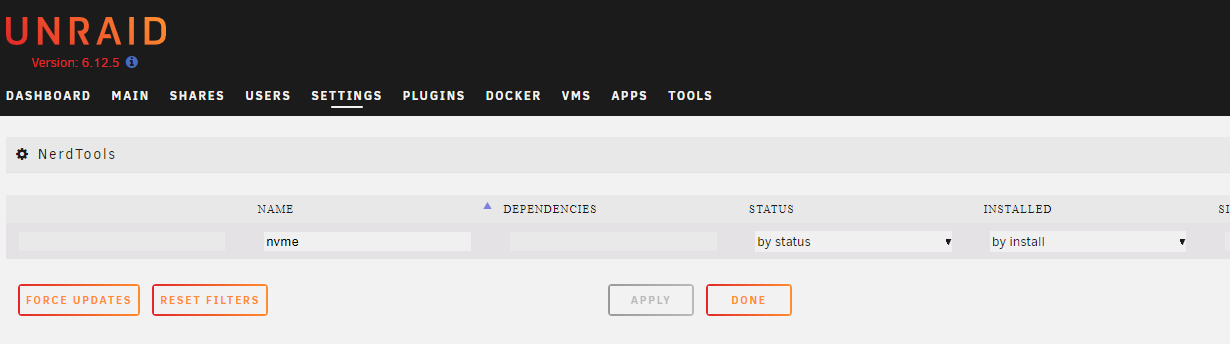

There is something wired with my setup. I am looking for nvme-cli tool and I saw someone already requested it. Then I start looking around but I can not find it in my NerdTools Then I found it is present in below location At the same time I can see NerdPack location with some packages in there What is the problem with my config? Does the NerdPack can somehow interreference with NerdTools? I have NerdPack uninstalled. Shouldn't be these removed as well?

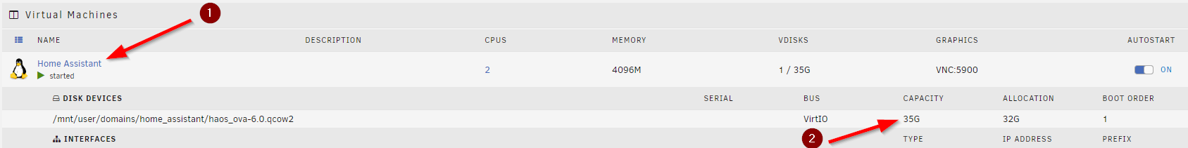

I did solve it. Here is the solution:
Unable to increase vDisk size for HAOS VM
To anyone who want to do this having VMDK image. Make backup of you VM - just in case Shutdown your VM Convert VMDK to qcow2 qemu-img convert -p -f vmdk -O qcow2 /mnt/user/domains/home_assistant/haos_ova-6.0.vmdk /mnt/user/domains/home_assistant/haos_ova-6.0.qcow2 Change the path to your new disk in your VM Change the type from raw to qcow2 in your VM <driver name='qemu' type='qcow2' cache='writeback'/> <source file='/mnt/user/domains/home_assistant/haos_ova-6.0.qcow2' index='1'/> Update the setup, click on the VM and increase the disk size in UNRAID UI
