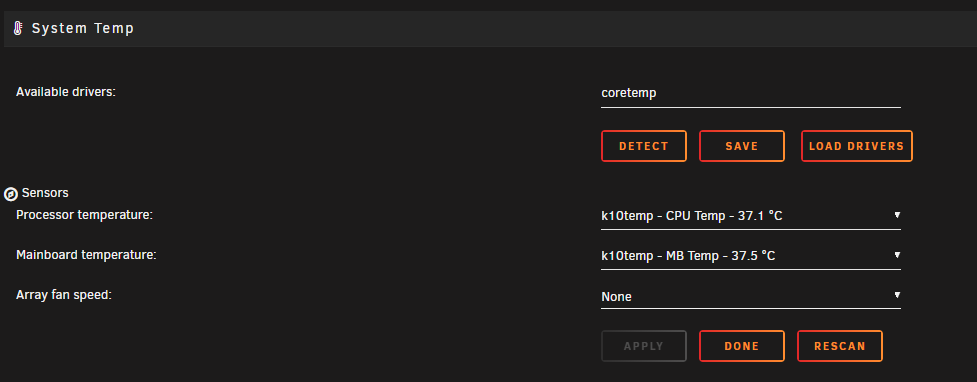

  2. I'm using the coretemp driver.
  3. I've just fitted one of these this week. I was using an old 8th gen intel i7 laptop before. Up and running with 64GB of ram. No Nic issues as yet, I'm getting full 2.5gb. These don't have SATA so I'm not sure of if were talking about the same motherboard, Here's the link to mine. No stability issues as yet, for HBA I'm using a LSI SAS3224 in the x16 slot. Longest uptime so far is 3 days (no crashes or lockups) but I've been performance testing so lots of load. Transcodes/AI I use a 4060TI in an adaptor in one of the M.2's so I can't speak for the onboard M610. As for performance it's very fast, a ton of headroom for VM's, and all the docker you could want. I don't even have turbo enabled so am limiting to 2.4Ghz per core. I've completed a burn in with it enabled and maxed at 75'c, Disabled not going above 50'c on full load. Currently running a Parity check with 6 older SAS drives 1.5GB/Sec total transfers CPU usage is 3-4% with 9 dockers (inc plex) and a windows VM running. The only issue I have with it is the temp monitoring is not great for reporting, but that's a known issue. I've got it working monitoring the 2 CCD's in the CPU each of which has 8 cores, this was easy enough by enabling corefreq. Got questions or want me to check something ask away, happy to try and help.

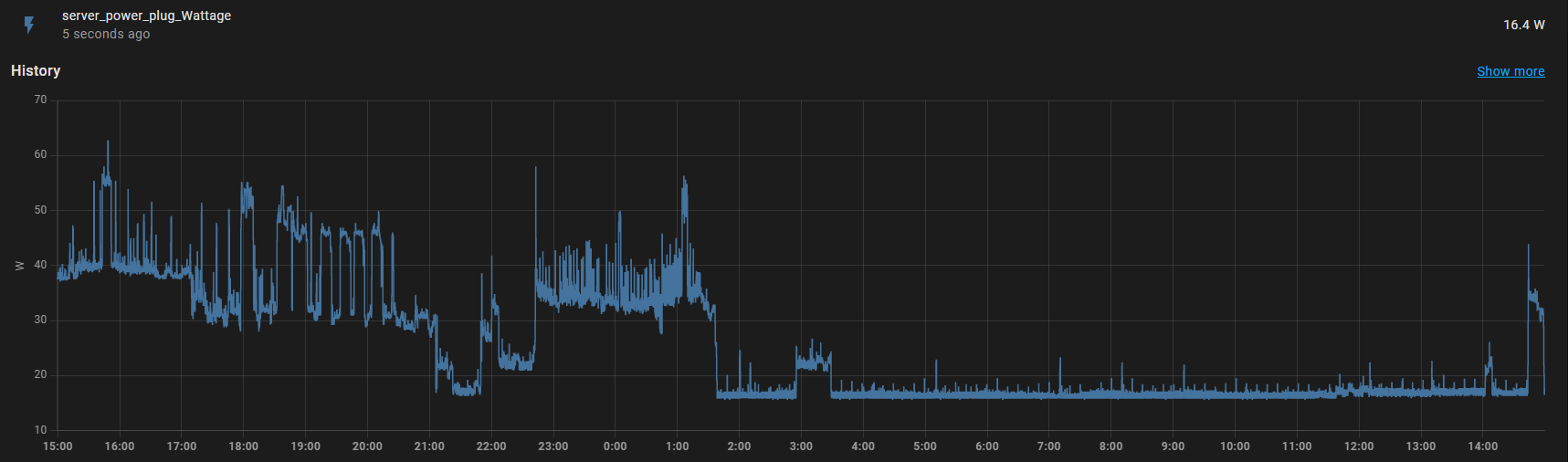

  5. The disk2 rebuild without issue and doesn't look to be have reported any further issues (diag attached). I did notice after running through the old diags that the ata error on the 582 controller was reported 5 seconds after running the powertop script (log section below). I've stopped the powertop autotune not run on this boot. Could this be an issue with the controllers/drives not working well with powertop? Vr2lo: The input voltage to both the laptop and the M2-ATX is 19V from the same PSU. Power usage measured at the mains as per the graph below, (Disk 2 rebuild finishing at the start of the graph, Mostly idle the 2nd half) The issues also seem to have happened when the disks were already spinning which I think counters the too little power and also too much power draw. I'll add a meter to monitor the output of the M2-ATX 12v line to see if it dips. My current thinking is to leave it to settle for 3-5 days and see if any errors show up, if all clear I might run powertop and see if anything changes. I know powertop has options to exclude devices from it's tuning. tower-diagnostics-20221227-1443.zip
