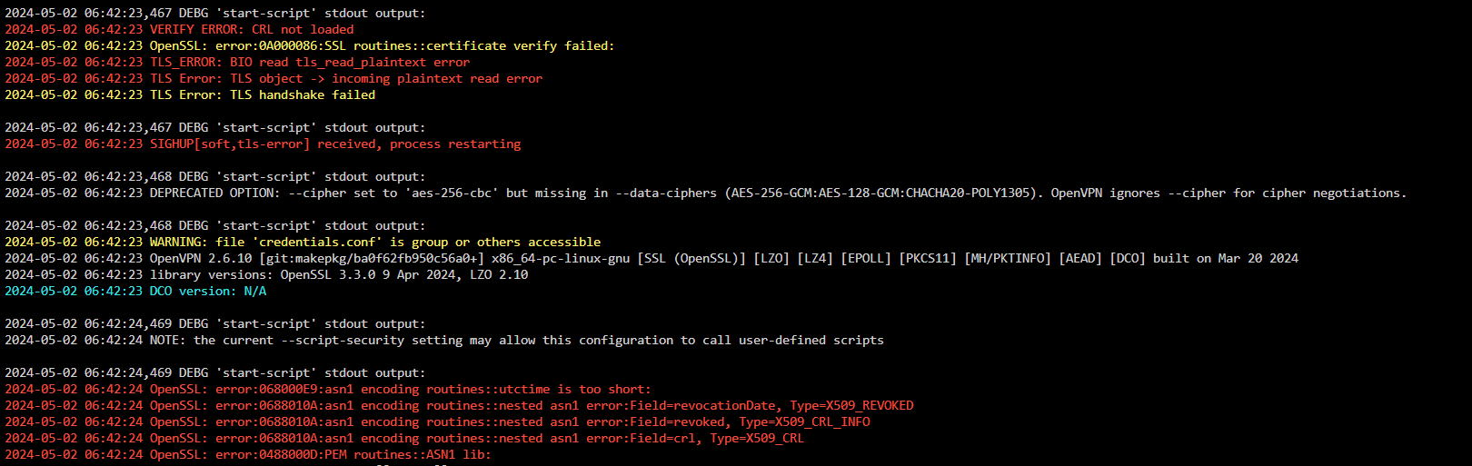

  4. Updated the container today and now the application won't start. I'm using PIA VPN, and it must be related to establishing the connection because when i set VPN_ENABLED to NO the application works just fine. I've download new config files from PIA and tried different versions, none seem to work. Can some help me figgure out what is going wrong? The log output: Edit: just reverted from tag:latest to tag:4.2.3-1-06 and everything is working again.
