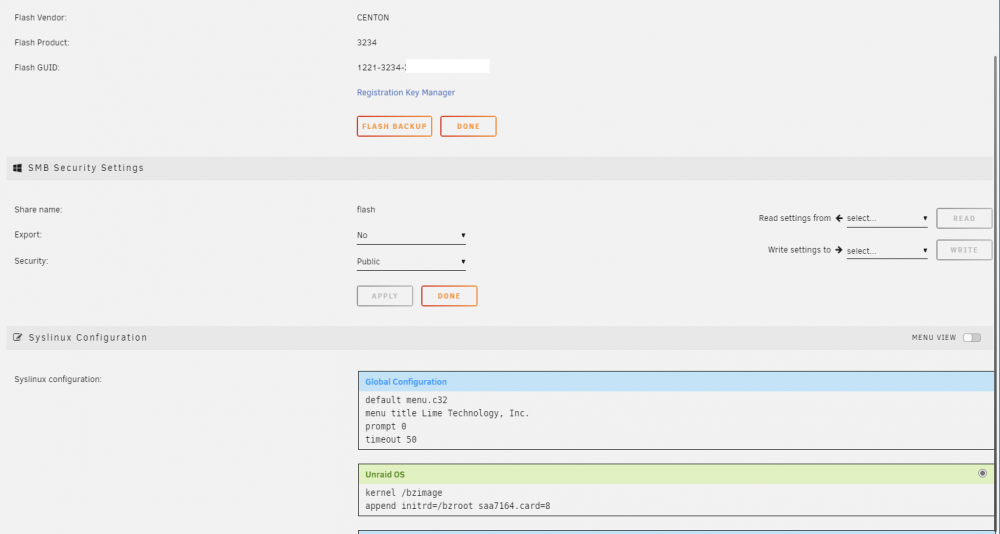

  10. EDIT: I just found out I have two cards with two different dates, so I swapped my C2013 card for a C2009 card, and it now shows in the DVB-driver page! 😮 Now to figure out how to pass it through to my plex docker.
  11. Oh yeah, sorry! homesrv-diagnostics-20220216-1212.zip If I had to guess, these lines from the syslog, look problematic. Feb 16 15:17:31 HomeSRV kernel: mc: Linux media interface: v0.10 Feb 16 15:17:31 HomeSRV kernel: videodev: Linux video capture interface: v2.00 Feb 16 15:17:31 HomeSRV kernel: CORE saa7164[0]: subsystem: 0070:8851, board: Hauppauge WinTV-HVR2250 [card=7,insmod option] Feb 16 15:17:31 HomeSRV kernel: saa7164[0]/0: found at 0000:01:00.0, rev: 129, irq: 16, latency: 0, mmio: 0xdf000000 Feb 16 15:17:31 HomeSRV kernel: saa7164_downloadfirmware() no first image Feb 16 15:17:31 HomeSRV kernel: saa7164_downloadfirmware() Waiting for firmware upload (NXP7164-2010-03-10.1.fw) Feb 16 15:17:31 HomeSRV kernel: saa7164_downloadfirmware() firmware read 4019072 bytes. Feb 16 15:17:31 HomeSRV kernel: saa7164_downloadfirmware() firmware loaded. Feb 16 15:17:31 HomeSRV kernel: Firmware file header part 1: Feb 16 15:17:31 HomeSRV kernel: .FirmwareSize = 0x0 Feb 16 15:17:31 HomeSRV kernel: .BSLSize = 0x0 Feb 16 15:17:31 HomeSRV kernel: .Reserved = 0x3d538 Feb 16 15:17:31 HomeSRV kernel: .Version = 0x3 Feb 16 15:17:31 HomeSRV kernel: saa7164_downloadfirmware() SecBootLoader.FileSize = 4019072 Feb 16 15:17:31 HomeSRV kernel: saa7164_downloadfirmware() FirmwareSize = 0x1fd6 Feb 16 15:17:31 HomeSRV kernel: saa7164_downloadfirmware() BSLSize = 0x0 Feb 16 15:17:31 HomeSRV kernel: saa7164_downloadfirmware() Reserved = 0x0 Feb 16 15:17:31 HomeSRV kernel: saa7164_downloadfirmware() Version = 0x1661c00 Feb 16 15:17:31 HomeSRV root: Feb 16 15:17:31 HomeSRV root: ---------------Installation of DVB-Driver-Package successful---------------- Feb 16 15:17:31 HomeSRV root: Feb 16 15:17:31 HomeSRV root: plugin: dvb-driver.plg installed Feb 16 15:17:39 HomeSRV kernel: saa7164_downloadimage() Image downloaded, booting... Feb 16 15:18:05 HomeSRV kernel: md: unRAID driver 2.9.17 installed Feb 16 15:18:05 HomeSRV emhttpd: Pro key detected, GUID: 1..4 FILE: /boot/config/Pro.key Feb 16 15:18:31 HomeSRV kernel: saa7164_dl_wait_clr() timeout (no d/l clr) Feb 16 15:18:31 HomeSRV kernel: bootloader d/l has failed Feb 16 15:18:31 HomeSRV kernel: Failed to boot firmware, no features registered Feb 16 15:18:31 HomeSRV kernel: saa7164 driver loaded

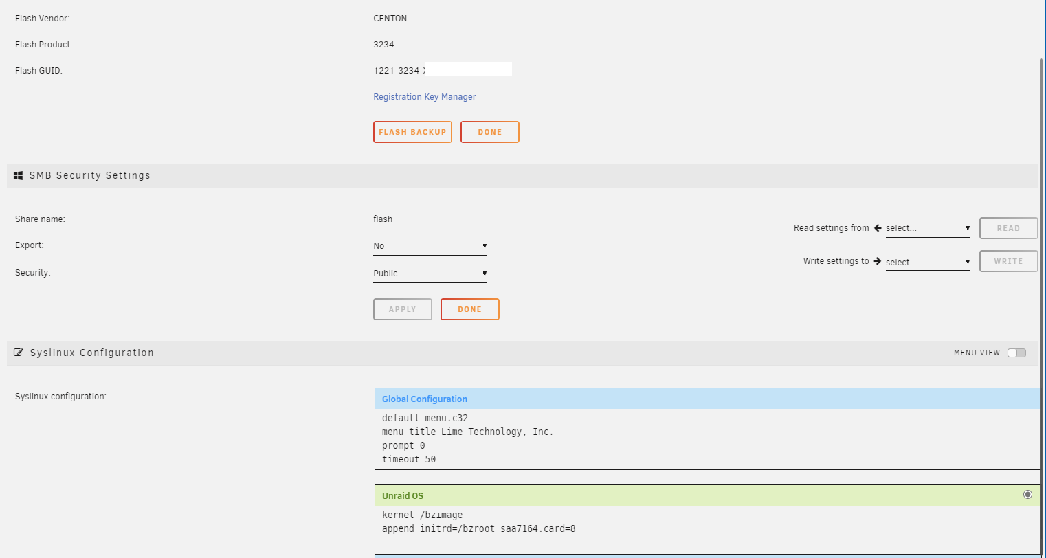

  12. Sadly still no dice.
  13. Yep, rebooted twice just to be sure. Here's updated diagnostics. homesrv-diagnostics-20220216-0411.zip

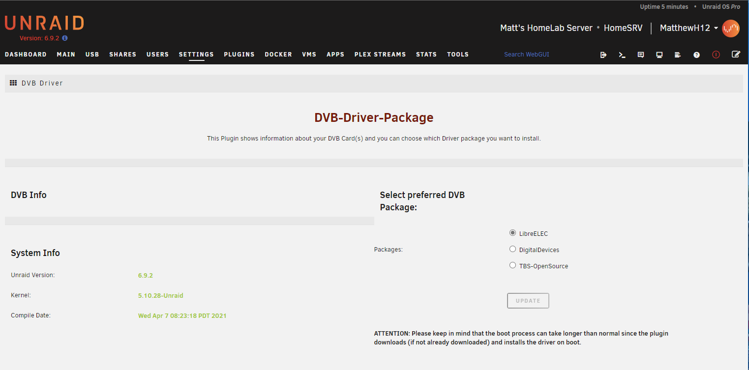

  14. No luck. =( root@HomeSRV:~# ls /dev/dvb /bin/ls: cannot access '/dev/dvb': No such file or directory

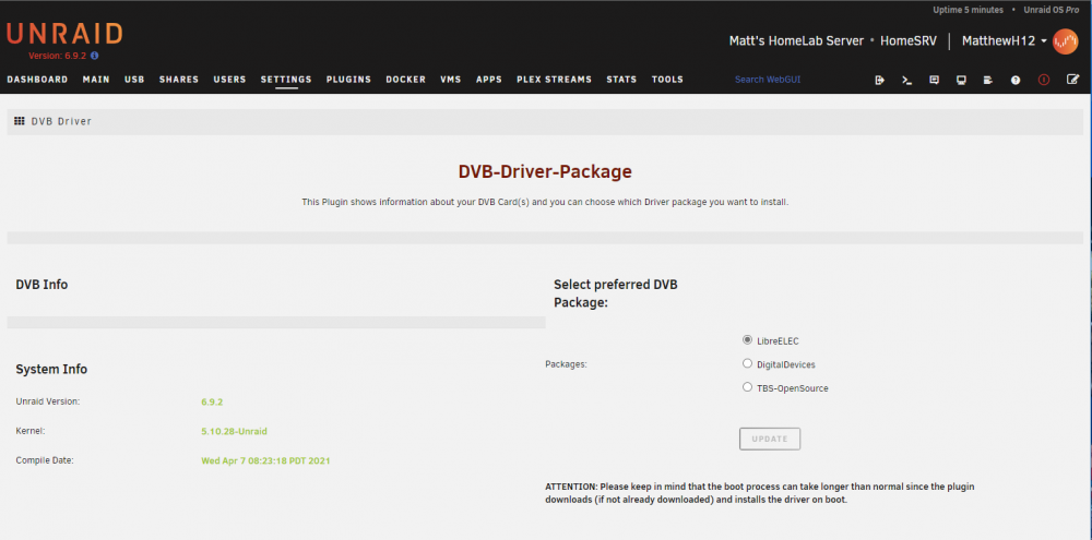

  15. Of course, here ya go! homesrv-diagnostics-20220215-2143.zip Thanks for getting back so quickly! I was surprised it wasn't just install and go...
