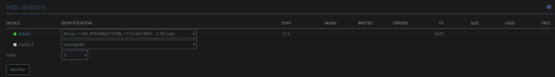

  1. Did the mirror and then re-mirrored again to get both NVME's in play and finally pull the last Micron out, seems to have solved everything cache related now and I just need to figure out my passthrough issue I was having but that's not related, I should be able to handle that as worst case I can just pull that entirely and recover manually if needed Also did push the latest update, I was hesitant on 7 for the longest time from horror stories I saw in the start of 7, but now that I have manual copies of all my stuff even if something goes wrong I can recover now at least. Guess I need to look into good ways to automate backups of my cache but that's it's own rabbit hole I guess Sent ya a couple bucks for the trouble, saved me from having to start over from scratch so next drink is on me! Thanks man!
  2. diags, not sure if usage shows in these but I'm currently copying out my appdata so if you see higher than idle thats why unraidmain-diagnostics-20260505-0948.zip
  3. it was setup as raid1, started the array and it looks like I'm back in business, or at least the cache mounts and I can see my crap again so I'm like 99% the way there barring any other disk issues, way better than I was before! Since it was setup as raid 1 though before, and the 2 TB micron has some smart warnings now (maybe what triggered this all?), what would you suggest as the best way to migrate over to dual NVME's and just get rid of the Micron all together? A) Should I add one of the NVME's, let it wipe then rebuild the raid, then pull the micron and repeat with the other nvme until it's rebuilt again on 2x NVME? B) Or should I just manually back it up (doing that right now anyways - appdata, domain, system), pull the micron, start both NVME's together as a fresh and wiped new start, and copy the backups back, leaving the MIcron as sort of an offline back at that point?
  4. Do you want to remove the signature? [Y]es/[N]o: n /dev/sdk1 : 2048 4000797359 (1.9T) Linux /dev/sdk2: write New situation: Disklabel type: dos Disk identifier: 0x95cf08d3 Device Boot Start End Sectors Size Id Type /dev/sdk1 2048 4000797359 4000795312 1.9T 83 Linux The partition table has been altered. Calling ioctl() to re-read partition table. Syncing disks. root@UNRAIDMAIN:~# btrfs fi show warning, device 2 is missing Label: none uuid: 45e8152a-9352-4226-a1c2-776cc68d5c45 Total devices 2 FS bytes used 251.08GiB devid 1 size 1.86TiB used 286.03GiB path /dev/sdk1 *** Some devices missing hey looks like we're moving somewhere, want me to start the array again now?
  5. right... sorry fighting the Monday BS at work lol root@UNRAIDMAIN:~# sfdisk /dev/sdk Welcome to sfdisk (util-linux 2.38.1). Changes will remain in memory only, until you decide to write them. Be careful before using the write command. Checking that no-one is using this disk right now ... OK Disk /dev/sdk: 1.86 TiB, 2048408248320 bytes, 4000797360 sectors Disk model: Micron_1100_MTFD Units: sectors of 1 * 512 = 512 bytes Sector size (logical/physical): 512 bytes / 512 bytes I/O size (minimum/optimal): 512 bytes / 512 bytes sfdisk is going to create a new 'dos' disk label. Use 'label: <name>' before you define a first partition to override the default. Type 'help' to get more information. >>> 2048 Created a new DOS disklabel with disk identifier 0x95cf08d3. Created a new partition 1 of type 'Linux' and of size 1.9 TiB. Partition #1 contains a btrfs signature. Do you want to remove the signature? [Y]es/[N]o:
  6. No clue, VM was getting IO issues as I tried to empty that passed through disk, thought a reboot might help, then nothing was showing on those cache drives after the reboot. only changes I ever made was assigning and unassigning disks trying to get them to pop back in, never formatted or wiped anything, only other commands I tried were the above ones in my OP. Never seen unraid act like this before over the years (on my 3rd unraid box now), I'm no linux guru but this one obviously stumped me lol root@UNRAIDMAIN:~# fdisk /dev/sdk Welcome to fdisk (util-linux 2.38.1). Changes will remain in memory only, until you decide to write them. Be careful before using the write command. Device does not contain a recognized partition table. Created a new DOS disklabel with disk identifier 0x3d49aff2. Command (m for help): 2048 2: unknown command
  7. root@UNRAIDMAIN:~# fdisk -l /dev/sdk Disk /dev/sdk: 1.86 TiB, 2048408248320 bytes, 4000797360 sectors Disk model: Micron_1100_MTFD Units: sectors of 1 * 512 = 512 bytes Sector size (logical/physical): 512 bytes / 512 bytes I/O size (minimum/optimal): 512 bytes / 512 bytes root@UNRAIDMAIN:~# fdisk -l /dev/nvme0n1 Disk /dev/nvme0n1: 953.87 GiB, 1024209543168 bytes, 2000409264 sectors Disk model: SPCC M.2 PCIe SSD Units: sectors of 1 * 512 = 512 bytes Sector size (logical/physical): 512 bytes / 512 bytes I/O size (minimum/optimal): 512 bytes / 512 bytes root@UNRAIDMAIN:~# fdisk -l /dev/nvme1n1 Disk /dev/nvme1n1: 953.87 GiB, 1024209543168 bytes, 2000409264 sectors Disk model: SPCC M.2 PCIe SSD Units: sectors of 1 * 512 = 512 bytes Sector size (logical/physical): 512 bytes / 512 bytes I/O size (minimum/optimal): 512 bytes / 512 bytes root@UNRAIDMAIN:~# blkid /dev/sdk root@UNRAIDMAIN:~# blkid /dev/nvme0n1 root@UNRAIDMAIN:~# blkid /dev/nvme1n1 Nothing comes from those bottom 3 Currently the Micron (sdk) is the one sitting in the pool config Above commands were done with arrays started, get the same info with it not running, still no output from that second set of commands
  8. I get no output from that command whether the array is running or not , that can't be good lol
  9. for reference the 1 TB WD Blue SSD (not getting a disk identifier right now for some reason) is the one that I knew had smart errors, that and the 2 TB TEAM SSD (sdl) are the ones passed into the VM so I know it wasn't one of those 2 for cache, I can fight with those later but main priority would be getting cache back so maybe I can save the VM and the one good disk and still dump all that data, plus all my dockers The 8x 8 TB drives in the main array seem to be fine and unaffected as far as I can tell, all shares on that are good and still work, it's only my cache that seems to be the issue
