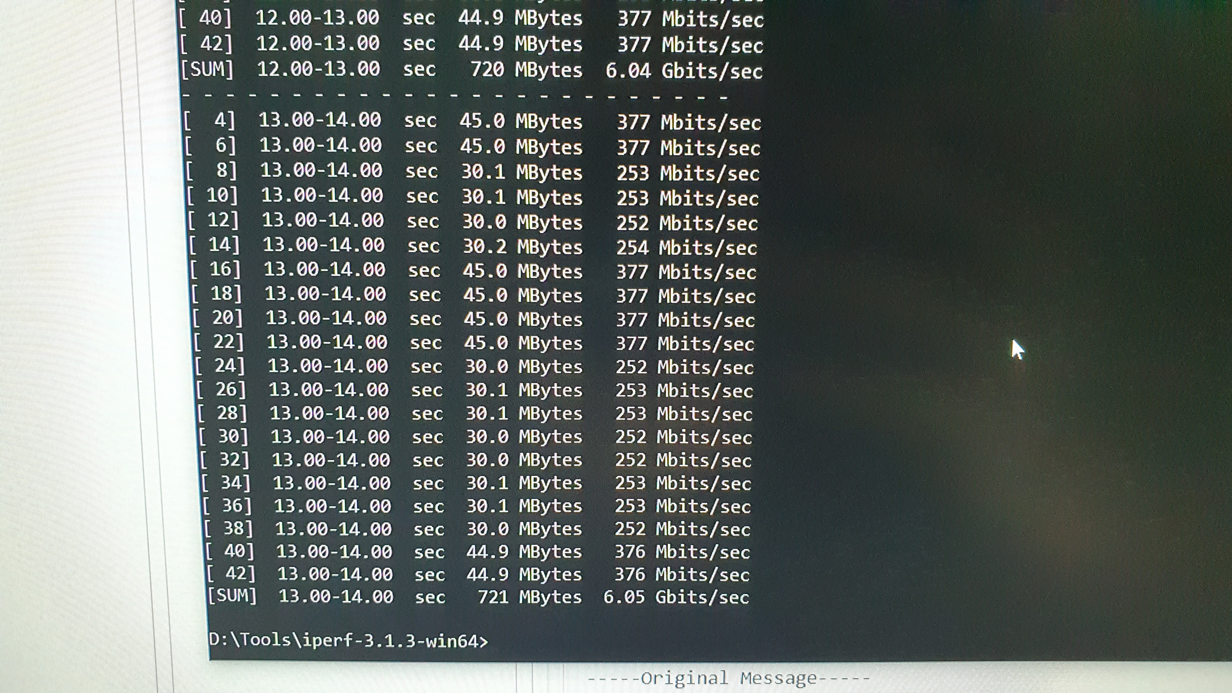

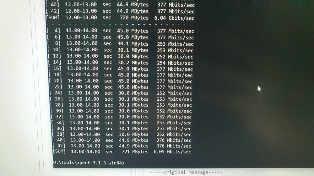

  1. Hey all, not sure if this helps but... I faced a similar situation with a itx board where the only pcie slot is occupied by a gpu. First I thought about using a splitter with bifurcation, but that adds to much hazzle with the case and the gpu will no longer perform at 100%. So I found another solution that involves a m.2 to pcie adapter. You can get those for 20 euros or so from Ali. Sadly mine was just a pcie 1x, so I ran into the same topic discussed here. I don't really care in the end, cause my NAS system cannot provide 10gbit throughput, so between 6-7gbit are really fine for me. I'm using mellanox connect x3 cards in all systems.
