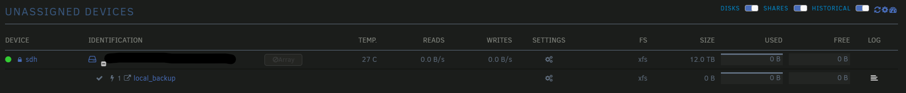

  2. Hello everyone, Since the last update I can't mount my backup drive anymore. I don't know what went wrong. In the past everytime I attached this drive it was automatically mounted and I was able to backup my data onto this drive. Now when I try to access it I get an error message like "/bin/ls: cannot open directory '.': Input/output error". The drive is encrypted with the same passphrase as the array is. I also do not know what this button means where normaly the "unmount" or "mount" button is located. Many thanks in advance. Edit: unRAID Version 6.9.2, UD Version 2022.03.11

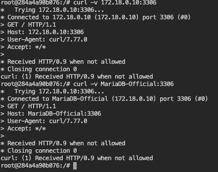

  6. Hi and thanks for your answer. I tried it over the ip address but I still got the same error: 2021/07/15 10:05:41 [error] 414#414: *51529 FastCGI sent in stderr: "PHP message: PHP Fatal error: Uncaught Doctrine\DBAL\Exception: Failed to connect to the database: An exception occurred in the driver: SQLSTATE[HY000] [2002] php_network_getaddresses: getaddrinfo failed: Name does not resolve in /config/www/nextcloud/lib/private/DB/Connection.php:85 Stack trace: #0 /config/www/nextcloud/3rdparty/doctrine/dbal/src/Connection.php(1486): OC\DB\Connection->connect() #1 /config/www/nextcloud/3rdparty/doctrine/dbal/src/Connection.php(1014): Doctrine\DBAL\Connection->getWrappedConnection() #2 /config/www/nextcloud/lib/private/DB/Connection.php(226): Doctrine\DBAL\Connection->executeQuery() #3 /config/www/nextcloud/3rdparty/doctrine/dbal/src/Query/QueryBuilder.php(210): OC\DB\Connection->executeQuery() #4 /config/www/nextcloud/lib/private/DB/QueryBuilder/QueryBuilder.php(287): Doctrine\DBAL\Query\QueryBuilder->execute() #5 /config/www/nextcloud/lib/private/AppConfig.php(345): OC\DB\QueryBuilder\QueryBuilder->execute() #6 /config/www/nextcloud/lib/private/AppConfig.php(1" while reading response header from upstream, client: <Client-IP>, server: _, request: "PROPFIND /remote.php/dav/files/<username>/ HTTP/1.1", upstream: "fastcgi://127.0.0.1:9000", host: "<Host-IP>" I also tried your suggestion but with no success. I got the following error with both, the hostname and the ip address. After I ran the command the logs of MariaDB say the following but the same error appears when I run the command from Nextcloud container to the older working MariaDB container. 2021-07-17 20:00:04 4 [Warning] Aborted connection 4 to db: 'unconnected' user: 'unauthenticated' host: '172.18.0.4' (This connection closed normally without authentication) This means that the Nextcloud container can reach the MariaDB container although the errormessage says that Nextcloud can't resolve the hostname?When I try to make an action on the webinterface of nextcloud connected to the latest container of MariaDB the error appears and there is no new record in the log of MariaDB. Thats so confusing... I've never had somthing like this bevor. I tried the same command from another container (phpMyAdmin) and there the command has apparently been successful. They are all in the same docker network.
  7. Hi, today I upgraded the MariaDB-Official Container to the latest version. I use it to run Nextcloud and Gitea but after the upgraded it I got the following error in Nextcloud (Gitea just works fine): SQLSTATE[HY000] [2002] php_network_getaddresses: getaddrinfo failed: Name does not resolve in /config/www/nextcloud/lib/private/DB/Connection.php:85 I changed nothing in my Nextcloud configuration. I connect to the database by using the hostname of the MariaDB-Official container (what still works fine with Gitea). Both containers are in the same docker network. I already tried to give the MaraiDB-Official container a static IP address in the docker network and connect Nextcloud by this address but this didn't work. Meanwhile I rolled back to MariaDB-Official 10.5.11 and it works fine at the moment. What can I do? I'm a little bit overloaded with this problem because I do not know what else to do. Many thanks in advance.
