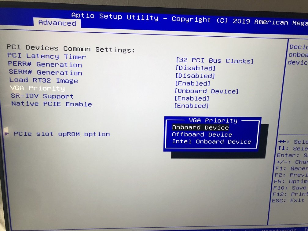

  15. Figured out, after setting in the BIOS for the "VGA Priority" from "Intel Onboard Device" to "Onboard Device" the intel_gpu_top works, also the transcoding in plex works after this change too. Just when the BIOS boots it picks my GT1030 GPU until unRAID loaded the i915 driver then unRAID switches back to the Intel GPU so that the GT1030 is still available for VMs. You may close the issue on the gitlab. Try it to without the file, but I can't imagine that this makes a difference... You're right, that made no difference. Also it works without connecting to any monitor. I'm glad that it works without requiring a dummy-plug.
