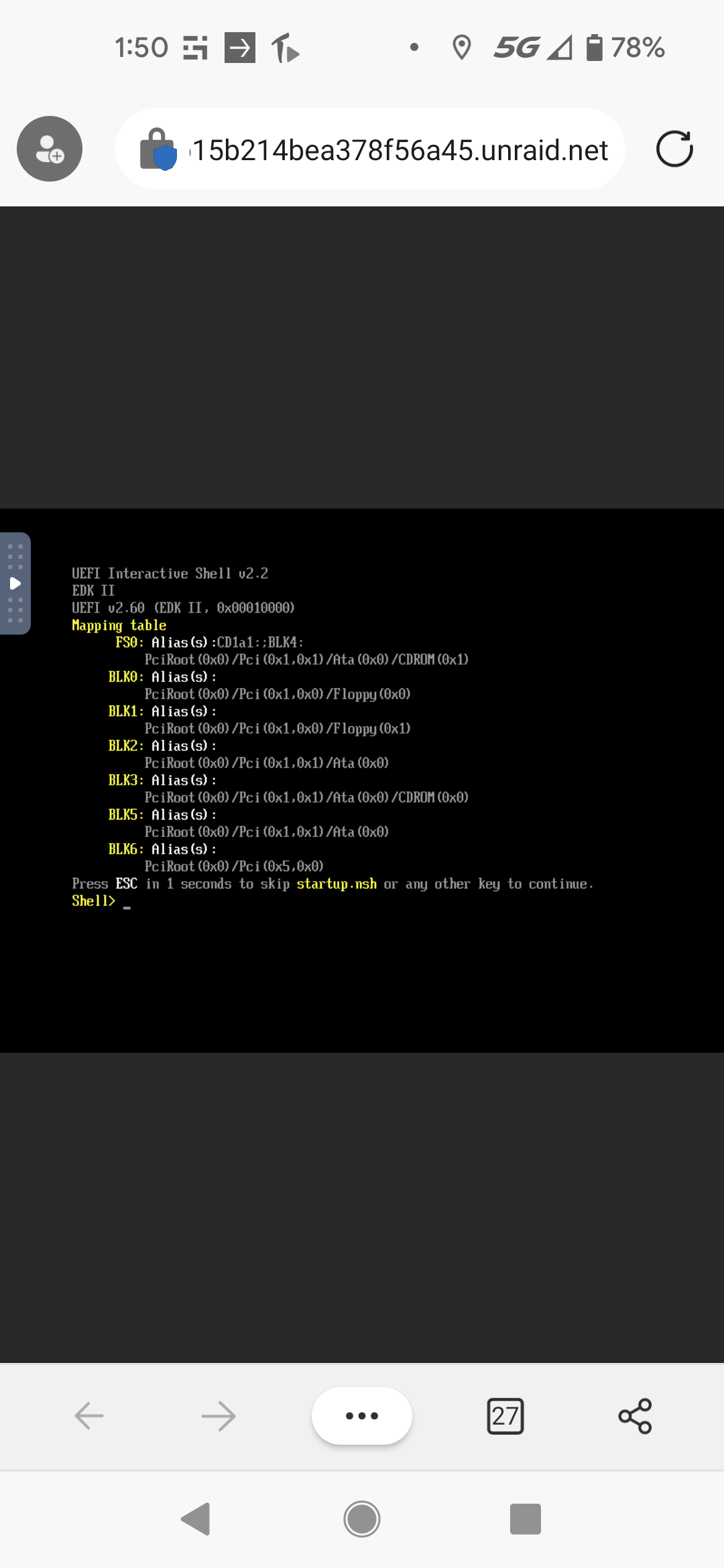

  8. I need some assistance on how to install a VM. I downloaded windows 10 iso. I created a folder called iso and place the windows 10 iso in that folder. I went to VM and hit created Windows 10 VM. I downloaded the driver's in the same folder and selected my settings. When it's ready to boot and it ask me to hit any keep to boot nothing happens. I just get what's shown in the screenshot I attached. Not sure why it won't launch windows 10 setup. Thanks
  9. So I was able to figure it out. I had to delete the folders I created in unRAID and create them from windows explorer. now I'm able to map the folders... Thanks for your assistance!
