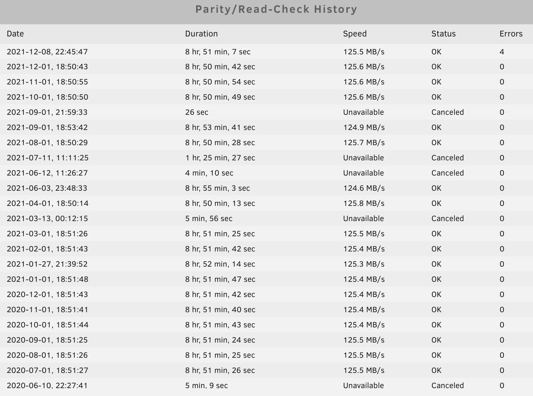

  1. Thank you all you guys for the comments, I think I have not explain it well. I was following this instruction: upgrading the 1TB data drive to 4TB data drive. the parity disk was not changed at all. I was using the rebuild process to fill the new disk with data, just the parity check shows 4 errors, I'm not sure if I should be very worried about the error. the 2nd time when I did the parity check, it show 0 errors now.
  2. thanks, this is without rebooting. new diagnostics of non-correcting parity check. m17-diagnostics-20211210-0900.zip
  3. thank you for the explanation. yes, I only format before I assign the disk of course. my question is still do I need to worry about the 4 errors? anyway to check what exactly the error is about? I'm attaching diagnostic file. m17-diagnostics-20211209-0849.zip
  4. yes, you are right, I meant 'assign'. it was a new disk, so it need to be formatted before I can use it for anything. yes, the disk I changed was data disk, not a parity disk.
  5. Hi Experts here: I'm using unraid for more than a year but still new to it. today I had to change my 1TB data disk to a 4TB one by swapping it.(no additional ports to add). the steps I took was turn off the server, replace the disk; turn on the server and format the new disk, then mount Assign the new disk to replace the old and start the parity rebuild process. after around 9 hours parity recovery data rebuild, the array is working with error saying 4 errors. should I worry about it? what should I do to check? cause I still have another 1TB data disk need to change to 4TB one thank you very much in advance for your kind answer.
