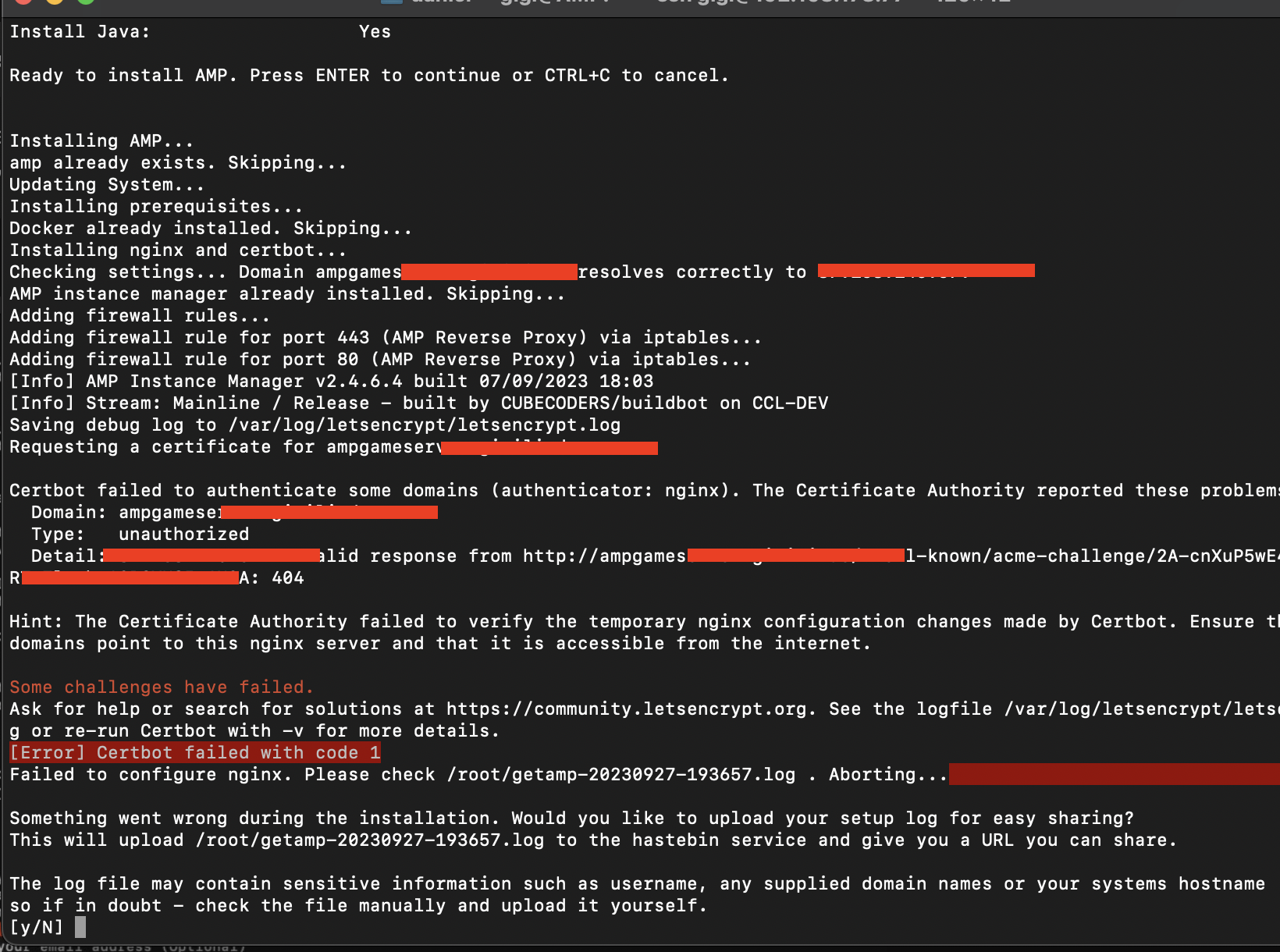

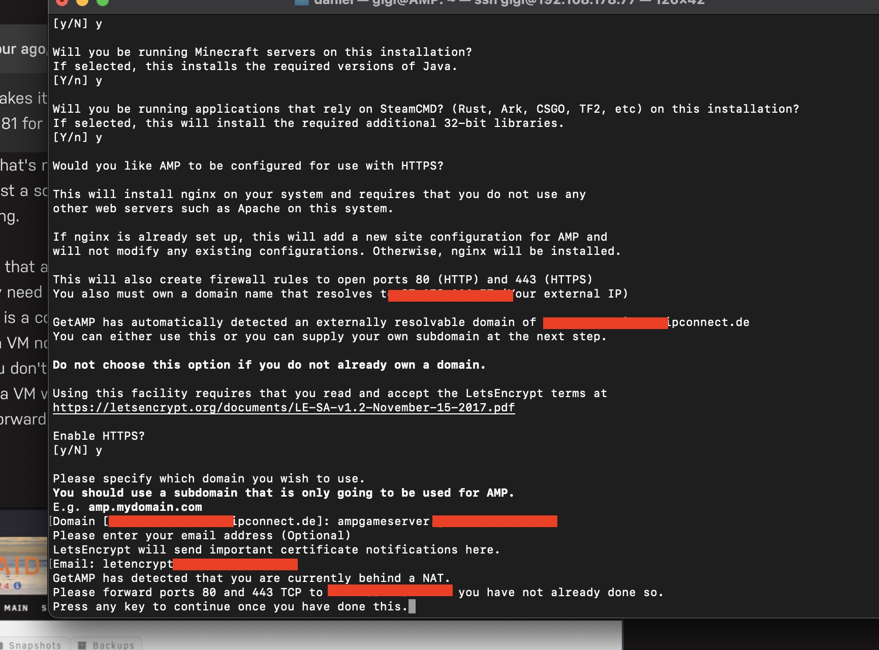

  1. I think that is the problem. I want to make it reachable from outside.
  2. Yes on Unraid via Docker. And NPM is reachable from outside on port 80 and 443. Yes i mean NPM Yes but when you start the script from cubecuoders it will fail. It asks for port 80 and 443. I tried 80 and 8080 but it stuck while the installation. How do you setup your reverseproxy before this installation? I found a command as i said lxc config device add mycontainer myport80 proxy listen=tcp:0.0.0.0:8181 connect=tcp:localhost:80 that makes it possbile like docker to work internally with port 80 but is reachable with port 8181 for exampel. you got me? in gernerell there are command like that in some forums, but we cant use them.
  3. @ich777 First of all, thank you so much for your work. I'm very new to Docker, LXC, VMs, and so on, so I decided to learn and host some applications like Pi-hole, etc. Please don't judge me; I'm new to this. I started by installing NPM, Redis, MariaDB, and Adminer as Docker containers so I wouldn't have to update them manually, and they are official images. My next idea was to set up Pterodactyl and AMP, but because there were no official Docker images available, I decided to create an LXC container. And here is where my story begins... I forwarded my Nginx to ports 80 and 443. Then, I created a Debian LXC container and tried to install AMP using the official script. The problem was that the script was trying to use port 80, which was already in use. My idea was to change the listener for the LXC container, similar to Docker, but it didn't work. After making some changes here and there in my port configuration, it started working. But now, when I tried to install Pterodactyl, I ran into the same issue and can't resolve it. Is there any way to change the listener for the LXC container? I tried googling it, and the answer I found was to use the command: "lxc config device add mycontainer myport80 proxy listen=tcp:0.0.0.0:8080 connect=tcp:localhost:80", but I can't seem to use this command. I have another question as well. Do I need to open the ports for every LXC host in my Fritzbox, or is it enough to open the ports just on my Unraid host? How have other people out there solved these issues?
