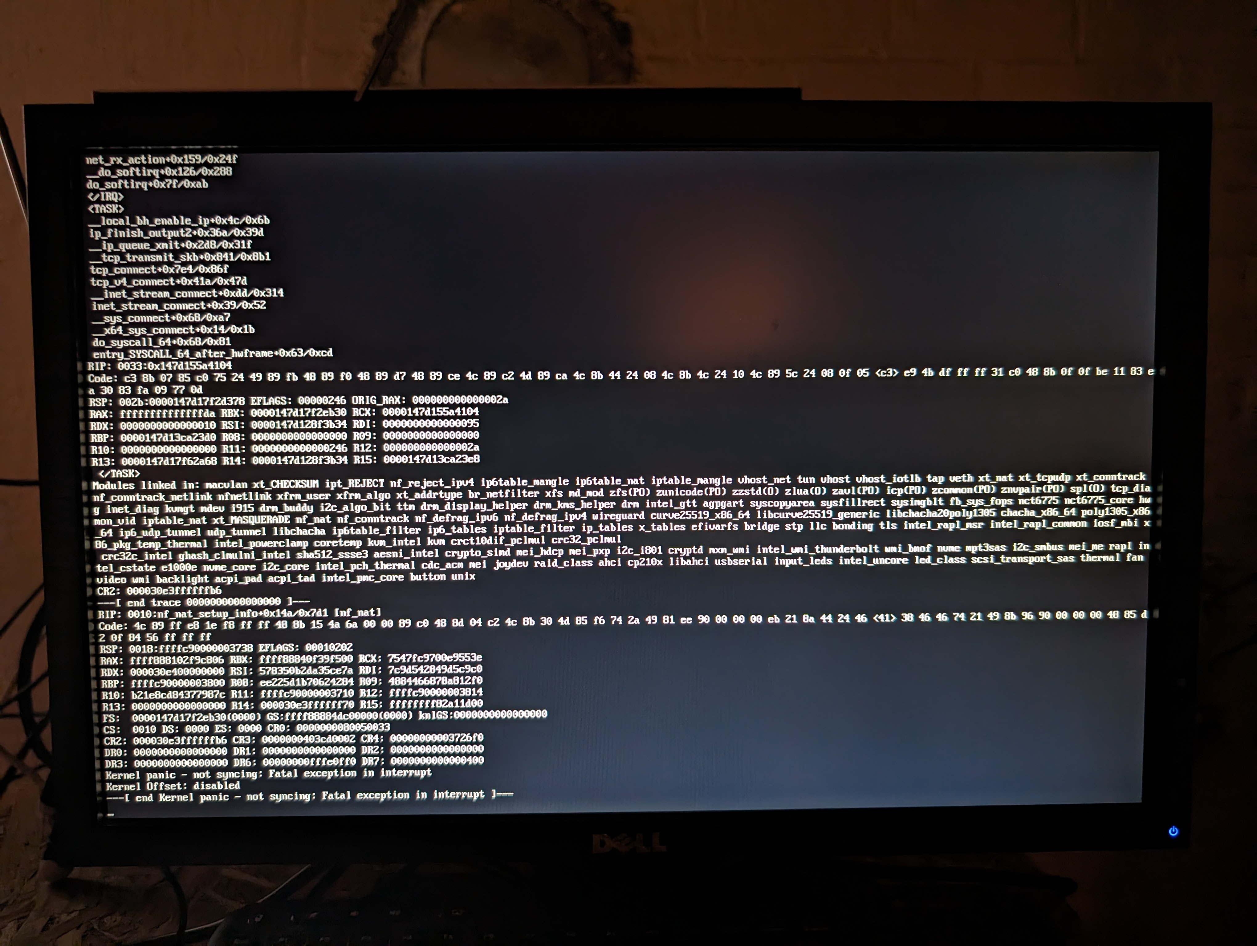

  4. Starting about a week ago my server started crashing every few days. I was able to capture the logs on the most recent crash and noticed there were many lines referencing a BTRFS issue. Any ideas whats causing this and how to resolve it? syslog errors: Dec 17 05:26:00 Tower kernel: BTRFS critical (device loop2): corrupt leaf: block=48136192 slot=140 extent bytenr=1060425728 len=8192 invalid data ref offset, have 4294936705 expect aligned to 4096 Dec 17 05:26:00 Tower kernel: BTRFS info (device loop2): leaf 48136192 gen 2207042 total ptrs 148 free space 4594 owner 2 Dec 17 05:26:00 Tower kernel: #011item 0 key (1059401728 168 16384) itemoff 16230 itemsize 53 Dec 17 05:26:00 Tower kernel: #011#011extent refs 1 gen 2084816 flags 1 Dec 17 05:26:00 Tower kernel: #011#011ref#0: extent data backref root 10841 objectid 12509 offset 37146624 count 1 Dec 17 05:26:00 Tower kernel: #011item 1 key (1059418112 168 4096) itemoff 16177 itemsize 53 Dec 17 05:26:00 Tower kernel: #011#011extent refs 1 gen 1407781 flags 1 Dec 17 05:26:00 Tower kernel: #011#011ref#0: extent data backref root 7995 objectid 17690 offset 0 count 1 Dec 17 05:26:00 Tower kernel: #011item 2 key (1059422208 168 4096) itemoff 16124 itemsize 53 ... Dec 17 05:26:00 Tower kernel: BTRFS error (device loop2): block=48136192 write time tree block corruption detected Dec 17 05:26:00 Tower kernel: BTRFS: error (device loop2) in btrfs_commit_transaction:2460: errno=-5 IO failure (Error while writing out transaction) Dec 17 05:26:00 Tower kernel: BTRFS info (device loop2: state E): forced readonly Dec 17 05:26:00 Tower kernel: BTRFS warning (device loop2: state E): Skipping commit of aborted transaction. Dec 17 05:26:00 Tower kernel: BTRFS: error (device loop2: state EA) in cleanup_transaction:1958: errno=-5 IO failure unraid_syslog_crash.txt tower-diagnostics-20231215-1623.zip
