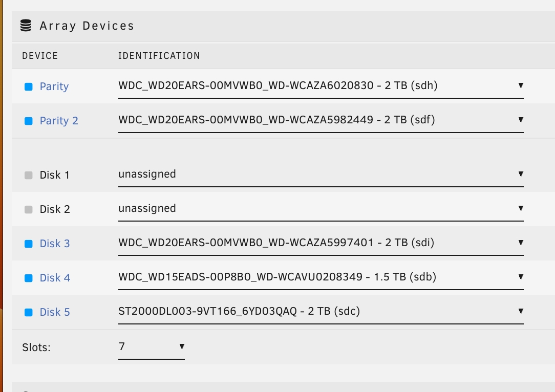

  1. After I few tries I got disk 1 back up and running and parity checked. Will replace it now. Thanks!
  2. Okay, thanks so much for the input! I really appreciate the time. I already tried rebooting and shuffling the cables, but I will try again. But this time I will perform the correct incantations, pray to the server gods first! Failing that, I'll try to work around it. Will update later today or tomorrow.
  3. Okay, I’ll fiddle around with it. But if I rebuilt without disk, that means all the data on disk1 will be gone?
  4. Hi, I don't know what to do. Please help! Version: 6.11.5 What: Was following guide to shrink array after a disk died, then a second disk died. The plan was to copy all the files off the empty disk (done), then remove the disk from the array and shrink it. Guide: https://wiki.unraid.net/Shrink_array#For_Unraid_v6.2_and_later Steps run Following the "Clear Drive Then Remove Drive" Method," guide Ran steps 1 - 12 successfully, so my disk was completely cleared, then config was cleared Started step 13, and found another disk had died. Other notes: Pic attached Disk 2 was the one I cleared (after clear it showed something like 14 GB free 10 GB used in the UI, not sure why) The drive that was in disk 1 is gone now (not in the drop down list) Step 13 in the guide I found confusing. Once I'm done that step, not sure if I just start the array with disk 2 empty, or if I shrink it from the drop down list and reassign.
