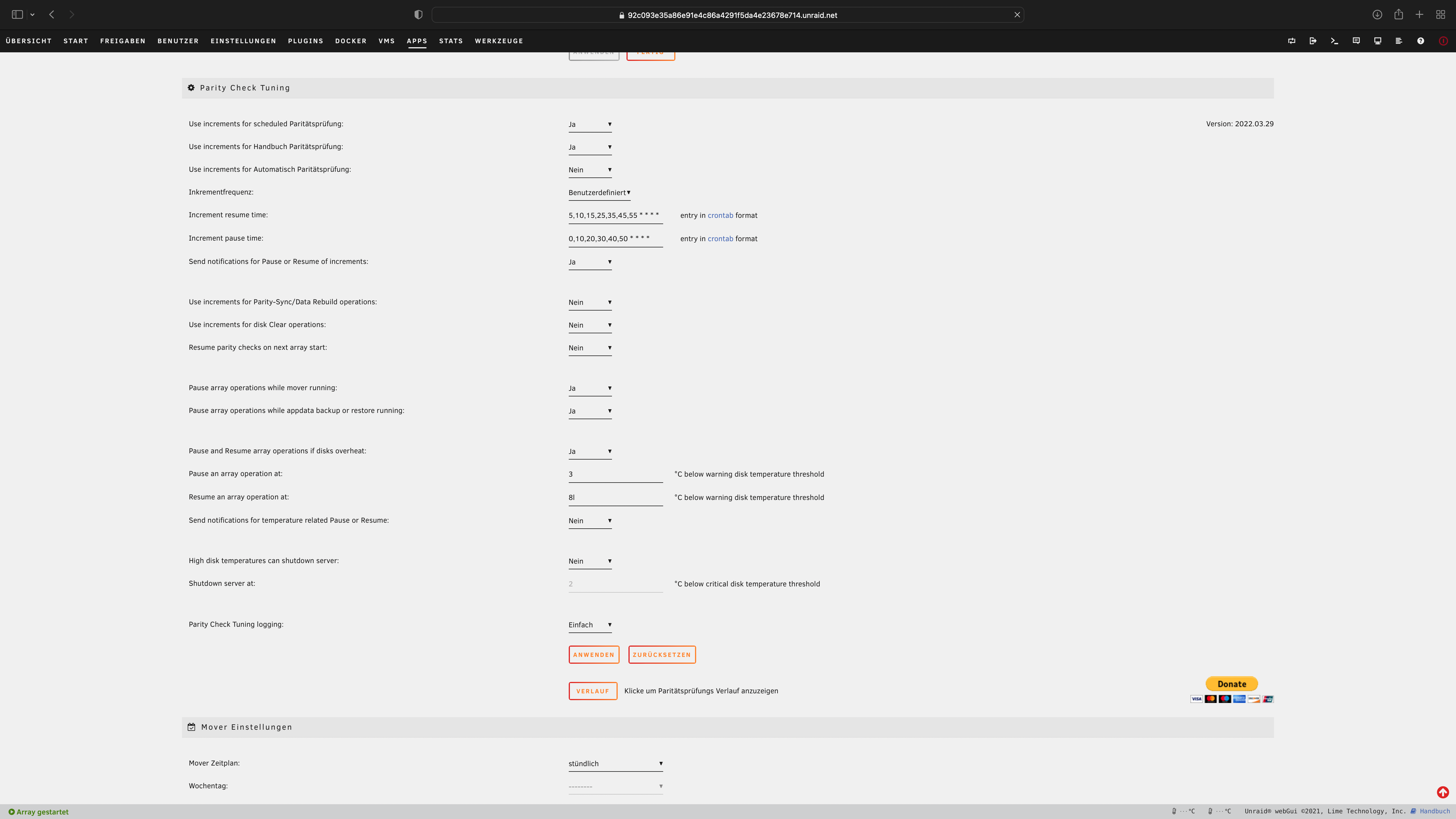

ah ok I will change it to daily then and see what happens Yep I usually did not set anything explicitly up besides the parity in parts and such and did not fiddle with the time settings also maybe one Idea would be if i configured something wrong that there should be a “reset settings to defaults” button that explicitly sets the conditions of the plugin the way you set it up initially. It is hard for me to find the right values for the heat pausing so I ended up disabling it (which did not have an effect actually) on 6.9.x on 6.10.rc4 it was disabled by default it seems- [Plugin] Parity Check Tuning
The issue is I have 2 unraid NAS servers one with the 6.10 rc4 which seems to have no issues running and the big older one with 6.9.x that is having the pause and resume issue - both have the same settings. Yesterday I uninstalled the plugin and let the parity check finish and it finished without overheating or other issues on the 6.9.x one. Gesendet von iPhone mit Tapatalk- [Plugin] Parity Check Tuning
I have an issue now that disabling the heat part of the parity check plugin has no effect - it still stops and resumed about every 5 minutes Gesendet von iPhone mit Tapatalk- I have an issue with my weekly parity check it starts and then pauses for hours

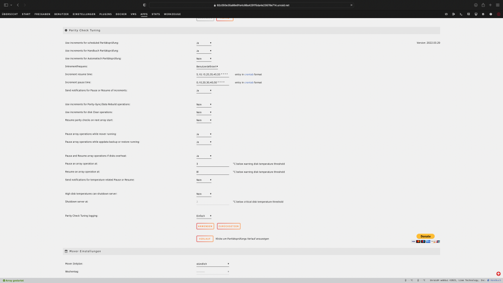

I did check the settings and it would wait for an 83 degrees C difference to continue …. Which never will happen btw my disks are about 40 degrees C in operation I think something was messed up in the plug-in so I uninstalled and reinstalled the plugin and the settings page still states to wait for 83 degrees C difference … Gesendet von iPhone mit Tapatalk- I have an issue with my weekly parity check it starts and then pauses for hours
Dear Support, I do have an issue with my dellnas server with the parity check it basically starts when it is scheduled but after a while it actually pauses "indefinately" until i continue to run it manually - this way it never completes fully at the moment. I will attach an actual diagnostic file for you to look at . Basically most other functions seem to run normal. Can you please help me fix this issue ? Thank you in advance, Best regards, Harald Weiss dellnas-diagnostics-20220329-1912.zip- Does Timemachine work on unraid for BigSur
