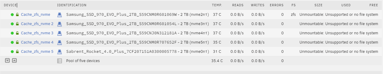

  3. I forced a power cycle. I rebooted into safe mode, started the array in maintenance mode, and it worked. -Booted safemode again - Started Array -System is stuck here like earlier today. I've attached new logs (the prior logs had no updates from what was posted after running ~6 hours other than a reboot command) -2 cpus are pinned at 100% utilization again - after ~32 minutes the array started as did one cache pool, the ZFS pool is still mounting -> I do not see a log entry that the other drives were available in the GUI zpool status -v output I guess this is a zfs issue? I'll look for next steps. My inclination is to give up on the data on the drive, kill the pool, format and build a new one? atlas-diagnostics-20250729-1626.zip
  4. My system has been down for a few months while I tried to troubleshoot a number of problems. It looks like the old motherboard went bad, and given the age of the Intel 10980xe, finding a replacement MB was tough. Finally, I found one and figured out the memory wasn't compatible. I upgraded the parity drives and SATA controller to a 9500-16i, etc. So I'm not super surprised I had a problem with a file system error given the problems that were occurring, but I can't get the system to a place to start fixing the fundamental problems (it seemed to be working until I tried to scrub the ZFS cache). Last night, after the scrub checking zpool status -v and seeing the bad files, I tried to delete them. The affected files were Plex cache/library files. That process ran an hour before I decided to shut down Docker. Then I tried to scrub again from the GUI. The system seemed to get stuck with 8 or so CPUs maxed out at 100%. I tried to shut down, and nothing changed, so I let it run overnight for 12 hours, and there was no change. I still couldn't shut down. I finally pulled the power this morning. Tried to start the array and after 3 hours it is still starting, and 2 CPU coresare pinned again. Tried to run fix common errors, it stalls at 36%. What should I do from here? I'm guessing this is all related to the corruption of the ZFS cache (running 5 NVMe's in a raidz1). atlas-diagnostics-20250729-1055.zip

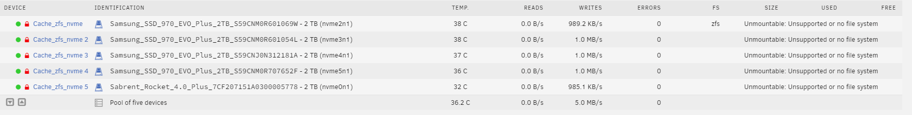

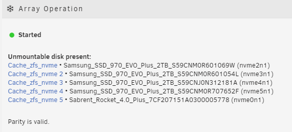

  7. I actually started and stopped the array a few times to run the commands and realized that when it was stopped it wouldn't work. Very strange. Since then I let an update run so I imagine finding the problem might be problematic in the diagnostics. atlas-diagnostics-20240405-2238.zip

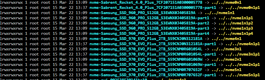

  8. As I mentioned above I tried zpool import when the array was running, along with: export and list. I spent about about 5 hours, without a reboot or me doing anything other than having the array running, reading dozens of support threads and trying to figure out why Fix Common Problems plugin reported this: * **cache_zfs_nvme (Samsung_SSD_970_EVO_Plus_2TB_S59CNM0R601069W) has file system errors ()** and that error was gone. So I decided to run: zpool list --> nothing showed up again zpool import and suddenly my pool was showing: @Atlas:/mnt# zpool import pool: cache_zfs_nvme id: 7422096033263261955 state: ONLINE action: The pool can be imported using its name or numeric identifier. config: cache_zfs_nvme ONLINE raidz1-0 ONLINE nvme2n1p1 ONLINE nvme3n1p1 ONLINE nvme4n1p1 ONLINE nvme5n1p1 ONLINE nvme0n1p1 ONLINE ---- @Atlas:/mnt# zpool import cache_zfs_nvme cannot import 'cache_zfs_nvme': I/O error Recovery is possible, but will result in some data loss. Returning the pool to its state as of Fri 22 Mar 2024 09:37:58 AM CDT should correct the problem. Approximately 6 seconds of data must be discarded, irreversibly. Recovery can be attempted by executing 'zpool import -F cache_zfs_nvme'. A scrub of the pool is strongly recommended after recovery. ---- @Atlas:/mnt# zpool list NAME SIZE ALLOC FREE CKPOINT EXPANDSZ FRAG CAP DEDUP HEALTH ALTROOT cache_zfs_nvme 9.09T 1.53T 7.57T - - 0% 16% 1.00x ONLINE - I stopped the array and then started it again and my data was back. Now I'm showing a different error: When I hover over the red lock, I get device locked with unknown error. After stopping the array and starting it again the red lock was gone. I don't know what to do at this point, or why it suddenly was able to be located and repaired. I'm concerned about this occuring again. I did lose a number of files in my plex docker directory (and apparently only plex). I am confused about how zfs protected my files if file corruption was possible at the disk level and not recoverable.
