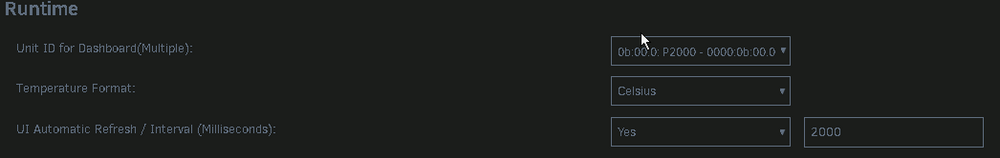

Ah good call, thanks! I found I have a couple plugin errors. I didn't know they would show up in another tab. My only option is to delete them, I can't update them or anything. Also it doesn't show what the error is, it just says Error in orange. Is there any way to see what the issue is? It appears that the gpustats plugin I was using doesn't exist anymore, or changed. I found a GPU Statistics that is working for me. -
Video card tile missing from dashboard after update
Squirreljester posted a topic in General Support
Since I updated to the new Unraid version my video card tile on my dashboard has disappeared. I looked in the tiles settings and all the tiles I can have checked are, but there's no option to add my video card tile back in. I miss seeing those statistics since I use it for my transcoder for Plex. Is there a way to get it back? -
