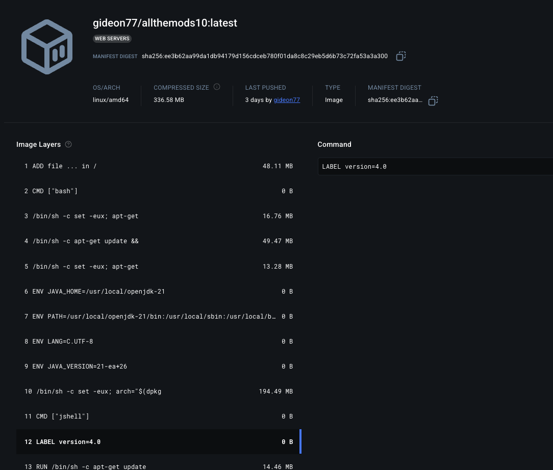

  2. Ahhh that will do it! Swapped it back over to W3lfare's and we are good to go - i see it downloading the 4.2 server files! Awesome thank you!
  3. Thanks for reply and I appreciate the help and work you have done :) I tried to change the tag and I get this error when I try to start the container I also deleted the contents of the app data folder after copying some of the config,world,server property files to a different location and I am still getting the 4.0 with the latest tag. I also did notice something on docker hub that seemed interesting, not sure if this has anything to do with what is going on. Once again I appreciate the help :)
  4. Looks like I can't get the update - I tried to force update and remove it (and the image) and reinstall with the latest tag and its still stuck on 4.0 Any ideas?
