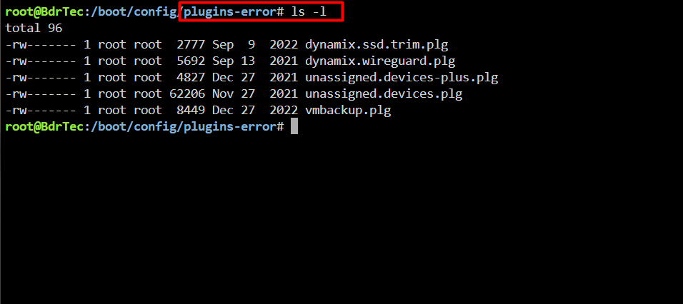

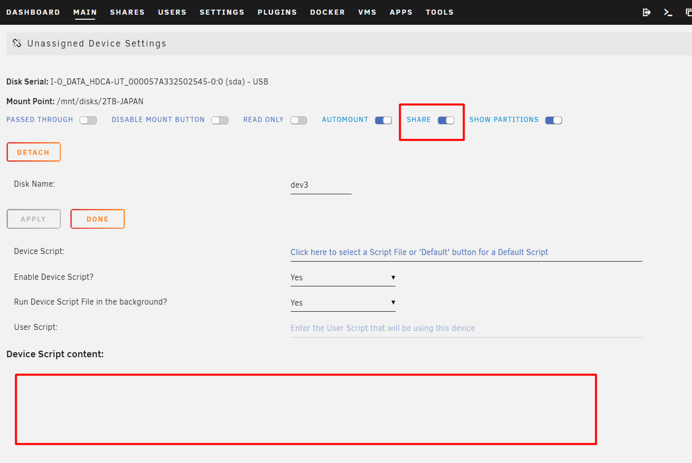

  19. I have an error in the configuration options. When I edit the settings it doesn't stay saved. Example: I can't add a script, I can't remove the sharing option. In the /config folder on the pendrive there is a folder labeled “/boot/config/plugins-error”. bdrtec-diagnostics-20240829-1108.zip

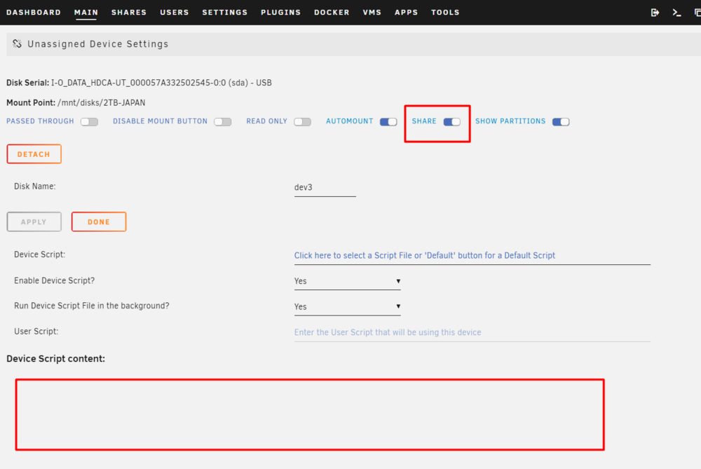

  23. I have an error in the configuration options. When I edit the settings it doesn't stay saved. Example: I can't add a script, I can't remove the sharing option. In the /config folder on the pendrive there is a folder labeled “/boot/config/plugins-error”. bdrtec-diagnostics-20240829-1108.zip
  24. @Frank1940@agarkauskas I restarted the server and it worked again. I didn't have to do anything. Maybe the files were not moved from the pendrive due to permissions or maybe only what was in the memory was moved. Tks for your help
