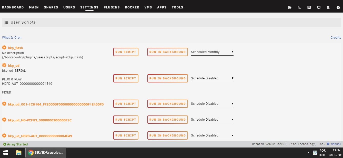

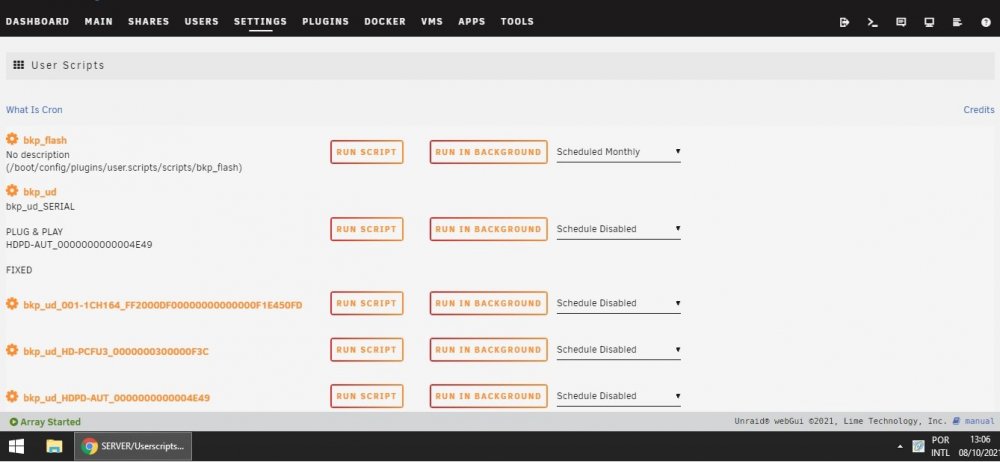

  1. Hey, guys. I created a backup script analyzing other scripts. The script make backup to PLUG & PLAY devices or FIXED devices and make incremental or sync backup. Any suggestions or corrections are welcome.
  2. Ladies and Gentlemen... These scripts do incremental or sync backup to: - PLUG & PLAY devices or FIXED devices - Local Folders - Drive (google, microsoft, etc) It's possible to schedule how often and what type of the backup will be done. When the backup start, you'll be notified by the email. When it finishes, too. https://github.com/bdrtec/Unraid-Bkp-UD-bdrtec https://github.com/bdrtec/Unraid-Bkp-Folder-bdrtec https://github.com/bdrtec/Unraid-Bkp-Drive-bdrtec
