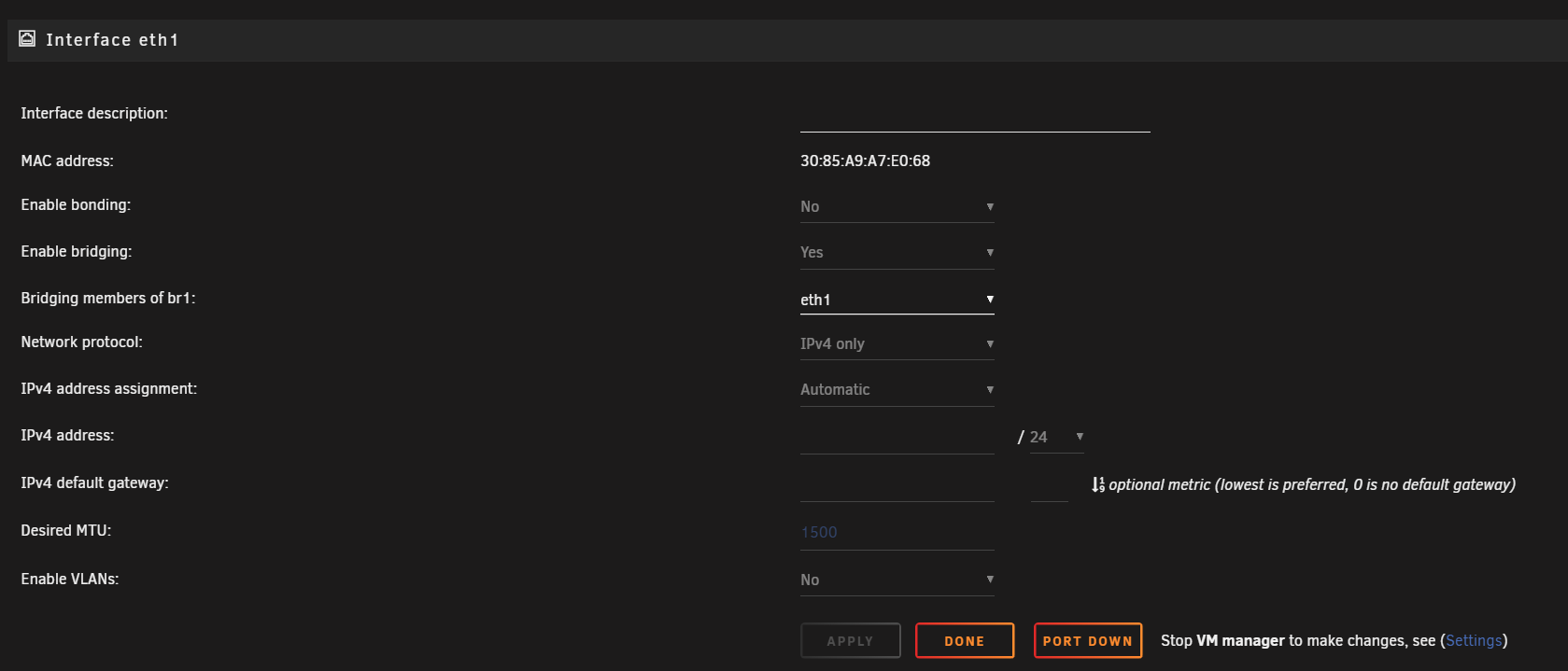

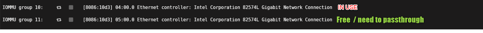

  9. HI, sry for beeing stupid, but all tutroials and posts are talking about using a networkcard or passing through ALL onboard Ports... but i only need to passthrough a single one (of my two ports) to a vm. I have a Asus P8B-M which has 2 Ethernet ports. One is in use for unraid the other one isn`t in use and i want to pass it through to VMs.... I managed to get them in separate IOMMU Groups but what now? Using append vfio-pci.ids=8086:10d3 would mean unraid loses both, right? So this would be quite bad^^ How to make only one free? Here is my network config for port 2 (eth1) that i want to passthrough.... i tried to "Port Down" it, but didnt helped... Maybe changing the VM XML? But i have no clue where to start, guides always refer to Networkcards but not to a single onBoardPort.... <interface type='bridge'> <mac address='52:54:00:3f:fd:d9'/> <source bridge='br1'/> <model type='e1000'/> <address type='pci' domain='0x0000' bus='0x06' slot='0x01' function='0x0'/> </interface> any ideas?
