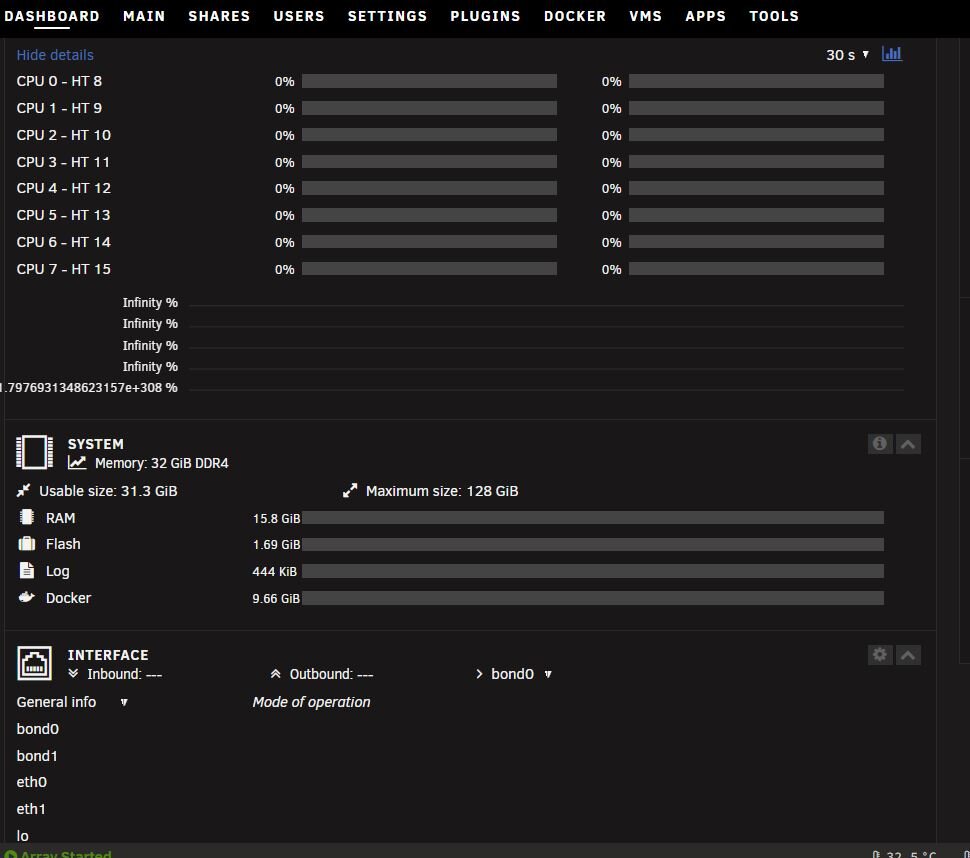

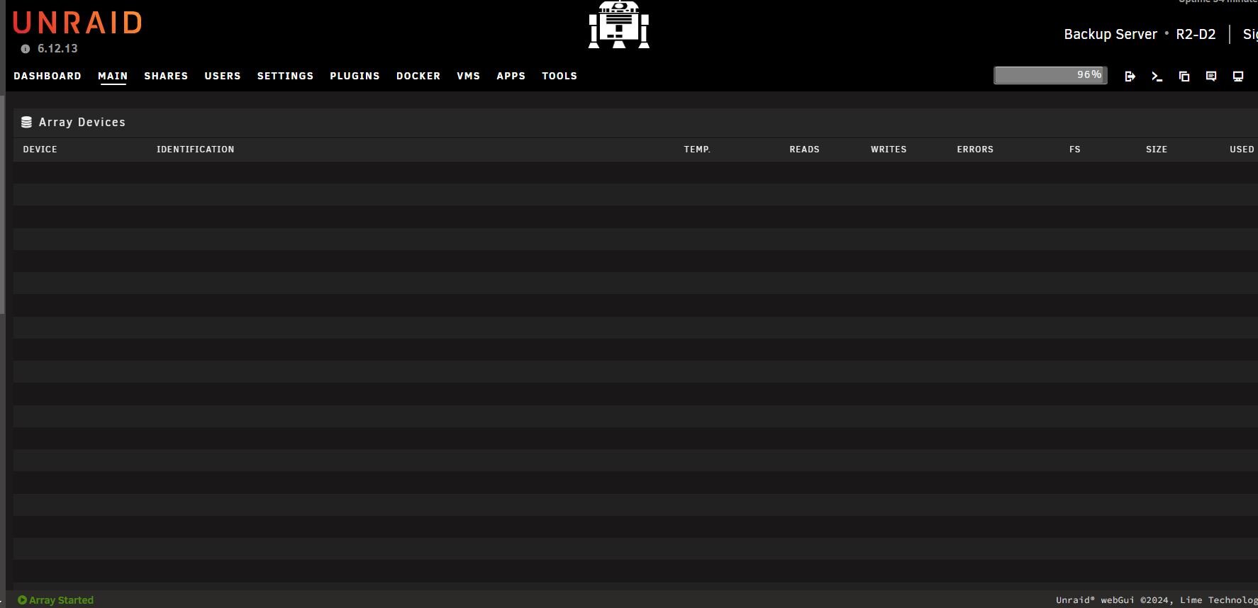

  7. It boots into safe mode and I can see the drives and dashboard stats no problem, but flipping it back to normal mode they disappear again. Safe mode was the only way it would allow me to run diags, so I'm thinking either the USB itself is dying (which doesn't make a ton of sense given that the server is running fine otherwise) or something in the config is corrupt. I pulled the USB and put it into another pc and it opens fine, no issues. I'm going to swap out the config and will report back. Using a different pc and browser didn't do the trick. That would've been too easy, haha.

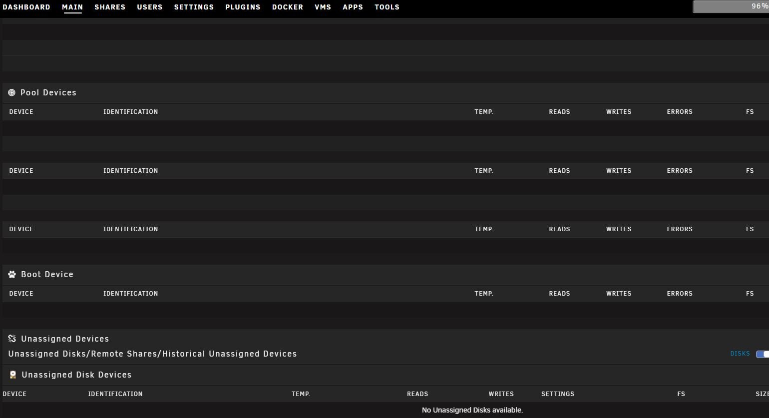

  8. I lost power the other day and now one of my servers is not showing any disks in the array or pools (see screenshots attached) outside of safe mode. The latter was the only way I could pull diags as well. Based on that I'm guessing it's a plugin misbehaving or maybe the config or something else got trashed in the power loss. Any thoughts on what could be causing it or how to fix it? Server is otherwise functioning normally. Diags and syslog also attached. Thank you! r2-d2-diagnostics-20241115-0921.zip r2-d2-syslog-20241115-1421.zip

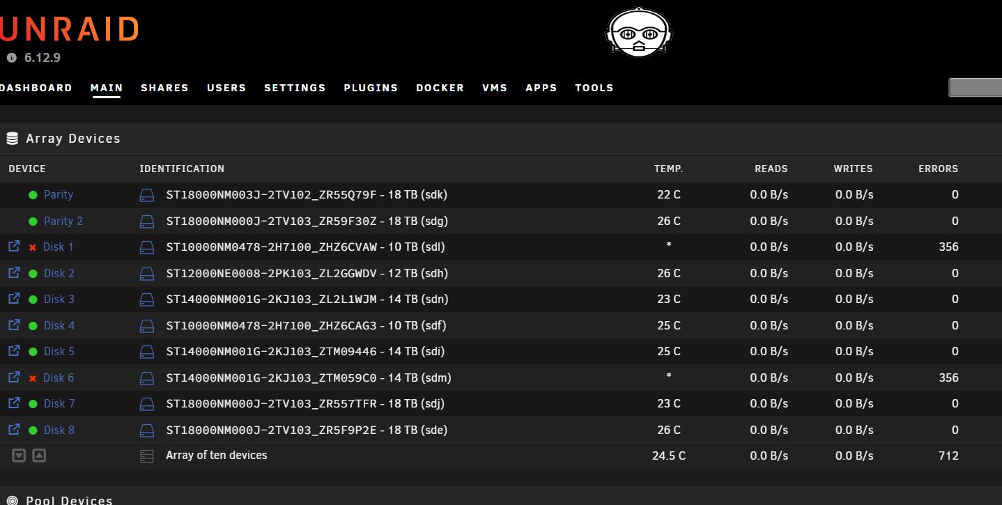

  10. I have an issue where disks keep disabling, but unclear why. Same two disks in last two days with the same amount of errors each time. I'm guessing it's a HBA, SAS expander or cabling issue, but don't see any immediately apparent errors in the logs other than the read errors and the disabling events themselves. That said, I also don't know enough about the logs to find the cluprit. Thanks in advance for any help! Diags and screenshot of disks attached. c-3po-diagnostics-20240403-0755.zip
  11. Similar issue on one of my servers that I can't sort out. Thought it might be an HBA/SAS expander overheating issue, but not seeing anything glaring to that effect in the logs. Added another fan blowing on both cards to see if that helps (since it helped a different server having the same issue (R2-D2)). For this server (C-3PO), the same two disks dropped out twice and with the same amount of errors both times, so thinking its also a power issue or HBA/SAS/connections-related and not disks failing but anything is possible. Any help is much appreciated. Thank you! Diags and screenshot of disks attached. c-3po-diagnostics-20240403-0755.zip
