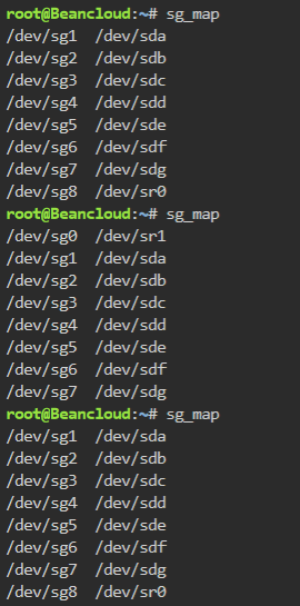

  15. So it looks like it's some sort of USB 3 boondoggle. The drive has been working rock solid since I moved it to USB 2.0. whether this is because of insufficient power delivery on my 3.0 ports, I don't know. Thanks for the assistance gang.
  16. I have a weird problem and hope someone can help. The docker itself works flawlessly when it's fine but my issue is that unraid keeps bouncing my bluray drive to different sr and sg numbers in /dev. So midway through a rip, the docker loses the drive and doesn't know where the device is. Then I have to go back into the docker extra parameters and point to the "new" device location. Does anyone know how I can avoid playing whac-a-mole with my drive? Can I assign a particular letter to it somehow? Any assistance is appreciated, thanks in advance. Here's a screenshot of my last few sg_map commands, more details - I have the drive connected to a USB 3 port.
