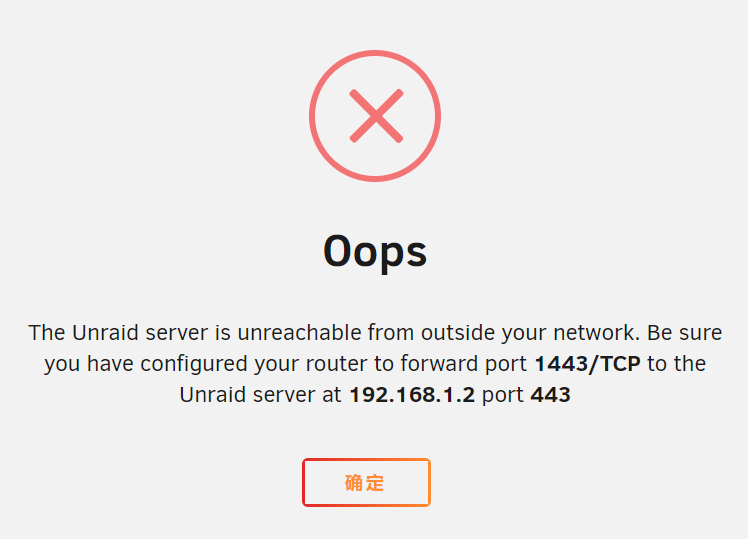

[Solved] The Unraid server is unreachable from outside your network
I wondered if it was because of the flash drive changing which may change the hash value too. So I deleted all the .pem files in config/ssl/, then reboot and re-provisioned the certificate file. After that, this issue solved.

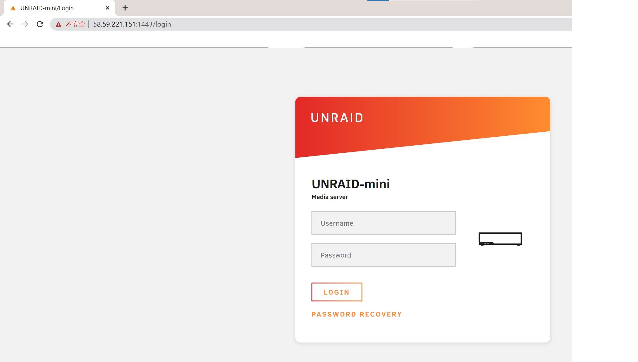

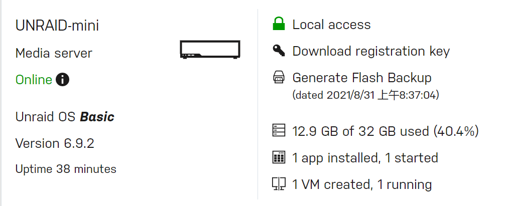

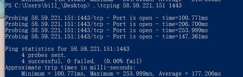

Hi, I installed this plugin a few days ago, and the remote access worked fine. But recently, I've changed my flash drive and re-installed this plugin, then the server couldn't reach my unraid server But I've set up my router's port forwarding correctlly. And the tcping tool can open the outer port 1443 (using cellphone hot spot). And I can also use the https protocol and ip with 1443 port to remotely open the management web (using cellphone hot spot). So can anyone help me with the official remote access?
