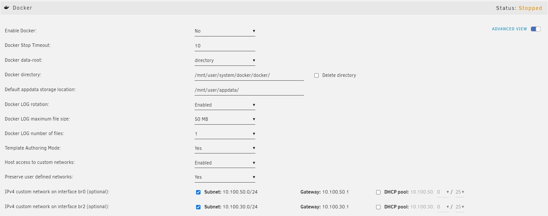

  5. I do not see a setting for "Docker custom network type" Am I looking in the right place? I went to Settings>Docker, the attached is what I see after I disable docker. When Docker is enabled this setting is also not there.

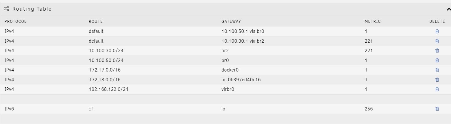

  6. I am unsure if it is. Attached is a snapshot of the network setup in my server. I would have thought that if it was setup related the issue would have been failry constant since inception. I have not added dockers or apps to the server since inception, always been the same. Not running VMs. I have had the smae network setup since inception. So the question is why initially did it only happen one a month if that, but gradually over the space of 12 months its gotten worse to where the server is crashing every few days? Perhaos I ned to simplify the network setup on the server, just have one phy interface? I am using static IP address on the SWAG docker, could this be an issue? Any help pointing me closer to where the issue could be is approciated. Thanks

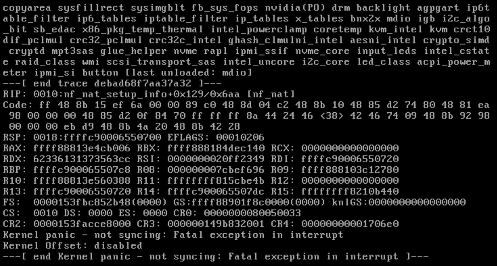

  11. HELP PLEASE!! - This has been going on for a long time. Started right after I first got the system up and running last year. It was happening perhaps one a month or less. Slowly it has gotten worse, every few weeks and now for the past month every few days sometimes goes a week without it happening. I have: Dell PowerEdge R720 dual CPU Intel(R) Xeon(R) CPU E5-2650 v2 @ 2.60GHz 8 x 16GB DIMMs DDR3 1600MHz Dual redundant power supplies NIC - built in - Intel(R) GbE 4P I350-t rNDC NIC card - BRCM 10GbE 2P 57810S-t Adapter All firmware is up to date. Kernel Panic spits out per the attached pic to the console, identical every time. The syslog appears to show nothing, everything seems ok then nothing logged as it crashed at some point after 1am then you see the reboot after I intervene at 7:51am: Jul 8 01:00:01 GanymedeII Docker Auto Update: Community Applications Docker Autoupdate running Jul 8 01:00:01 GanymedeII Docker Auto Update: Checking for available updates Jul 8 01:00:08 GanymedeII Docker Auto Update: Found update for ddclient. Not set to autoupdate Jul 8 01:00:08 GanymedeII Docker Auto Update: Found update for mariadb. Not set to autoupdate Jul 8 01:00:08 GanymedeII Docker Auto Update: Found update for nextcloud. Not set to autoupdate Jul 8 01:00:08 GanymedeII Docker Auto Update: Found update for plex. Not set to autoupdate Jul 8 01:00:08 GanymedeII Docker Auto Update: Found update for swag. Not set to autoupdate Jul 8 01:00:08 GanymedeII Docker Auto Update: Found update for unifi-controller. Not set to autoupdate Jul 8 01:00:08 GanymedeII Docker Auto Update: No updates will be installed Jul 8 01:00:48 GanymedeII emhttpd: read SMART /dev/sdd Jul 8 01:00:53 GanymedeII crond[2536]: exit status 1 from user root /usr/local/sbin/mover &> /dev/null Jul 8 07:51:10 GanymedeII kernel: Linux version 5.10.28-Unraid (root@Develop) (gcc (GCC) 9.3.0, GNU ld version 2.33.1-slack15) #1 SMP Wed Apr 7 08:23:18 PDT 2021 Jul 8 07:51:10 GanymedeII kernel: Command line: BOOT_IMAGE=/bzimage initrd=/bzroot
