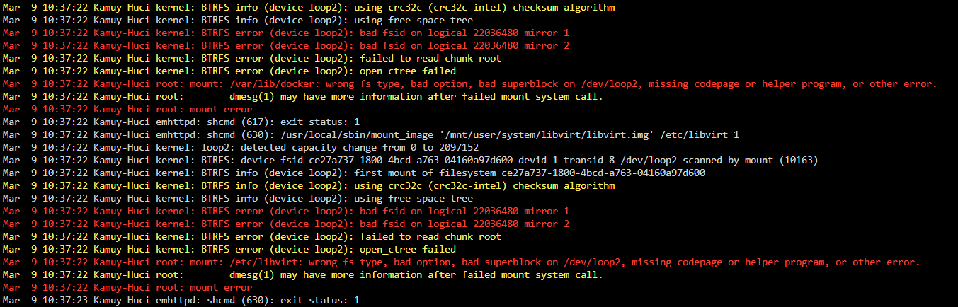

  2. Hi @JorgeB, Im in the process of recovering but i hit a wall. out of 3 main shares that were on the faulty drive : appdata has been copied to the array domains has been a failure (i guess it's my mistake, all the disks are 0 B) system has been copied to the array Now i want to resume operation (slower while waiting for the new drive to come in) it'll live on the array. I recreated the previous shares and rsync everything to it's place (from the backup share i created for that purpose) and that's where i may have messed up the domains. However when trying to start docker i have an issue related to loop2 i guess What did i do wrong and what are my next steps ? Here is the up-to-date diag : kamuy-huci-diagnostics-20250309-1045.zip

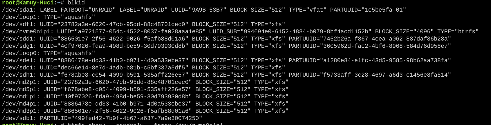

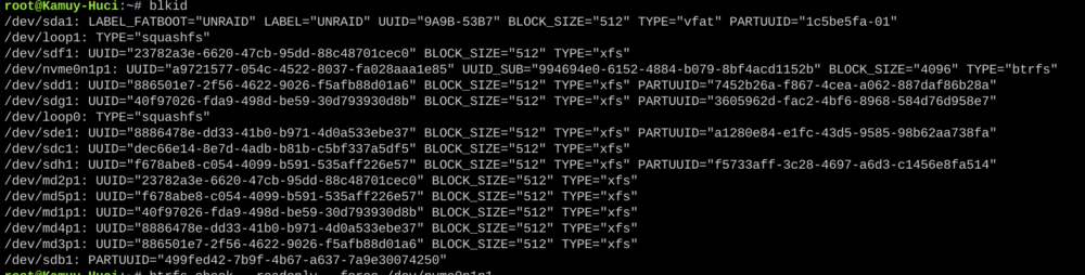

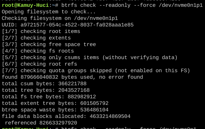

  4. Thanks, the data must still be there ! You're right. The disk was not physically found. I stopped the server, removed and added it back again and it was picked up by unraid. What should be the procedure ? 1. Putting it back on read / write mode ? 2. Using a fresh one, and copying everything on it ? (That'd be copy everything from failed onto array for temp storing purpose, by "mover", putting new one in and move back into new one) ? For the records the failed disk is fairly new, I don't think it's life is over yet (I'd prefer not have to spend another 100€ right after holidays ... )
  5. The title says it all. Came back from (short ?) holidays and everything seemed fine but i tried accessing plex and it failed (any dockers in fact) a few minutes later i discovered my "vm" disk (nvme0n1p1, which is also the appdata disk ...) is unmountable. On the main ui it appears as FS : Auto but looking around i ran : so it seems it was btrfs. I also tried a check : I have no idea where i messed up or if it is recoverable. Please help me, i am not willing to redo all my configs ... Of course, here is the diagnostic : kamuy-huci-diagnostics-20250307-2138.zip

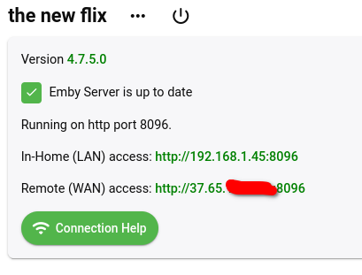

  15. Azarog posted a topic in Docker Engine
    Hello, i moved out and i received a new internet box. Im going on the router interface to forward the port for emby but it appear im on ipv6 now. No big deal, im looking up solution for this but it appear that my emby docker is As far as i know this looks like an ipv4 public address. So it looks like that it wont cut it. I've looked through this but : i dont know how to make an ipv4 dchp pool that wont collide with my router pool (i have an SFR ISP, french company) if i want to give an ipv6 address in custom br0 in the docker template, i dont know wich one to give for it work remotely I think i might be missing something, help would be greatly appreciated Also im not sure about which part of the config is wrong (be it the unraid part or the emby part or even both) Thanks in advance
