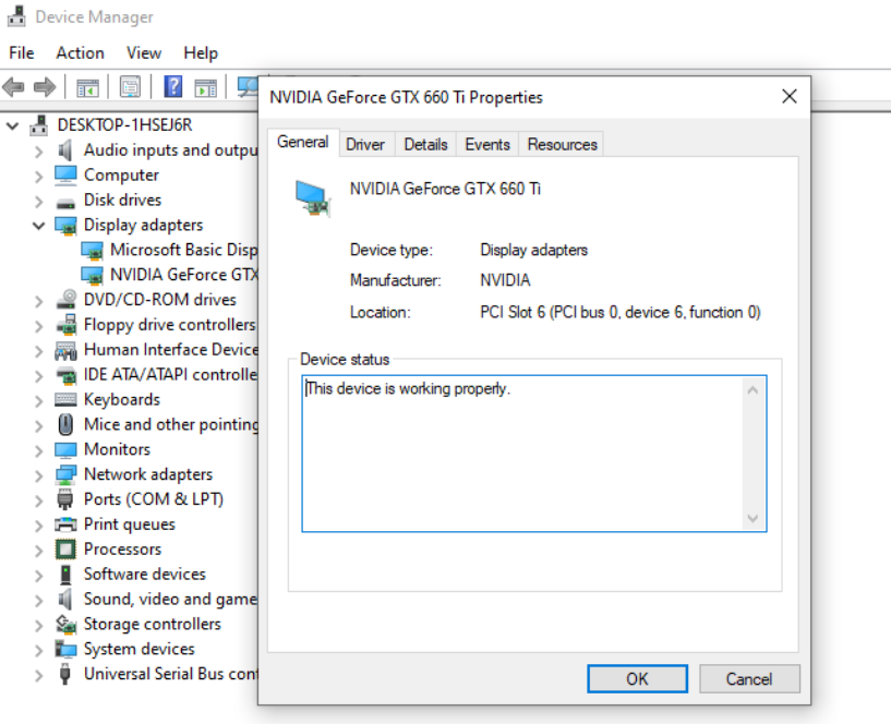

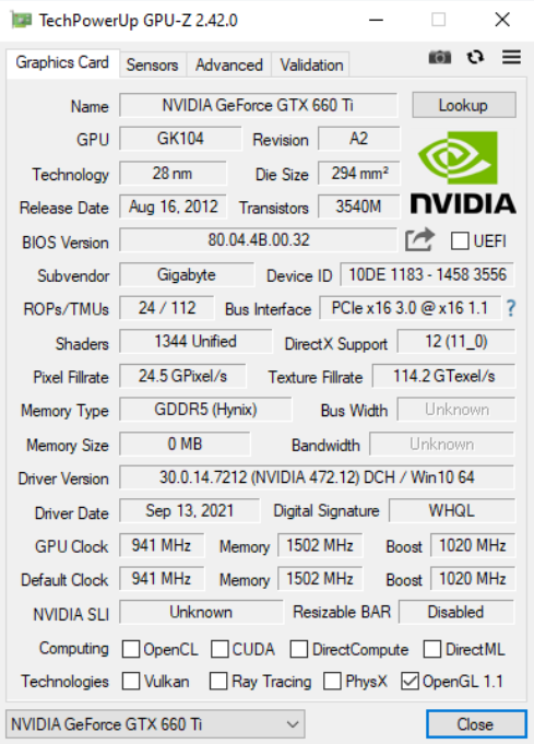

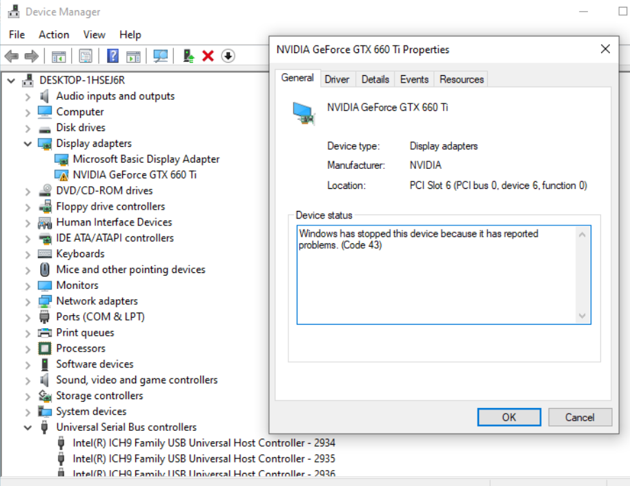

I'm confused at which step the drivers need to be loaded ? Here is what i get BEFORE trying to install drivers from NVIDIA wesite : And this is AFTER installing the drivers from NVIDIA website: Even with everything looking alright nothing comes out of HDMI ( or at least reaches my screen) GPU-Z showing this :
