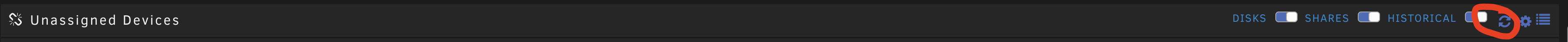

Hi The docker container always "used to work" (TM), but after it failed, I reinstalled the container and now I am in a mess. I know it says "network needs to be configured, but I have forgotten how... I cannot see the timemachine in my network, Timemachine app on Macos (sonoma 14.1.2) doesnt find it. My network uses 192.168.178.x / unraid is 192.168.178.31. From default I only changed network from "none" to "bridge" My command reads docker run -d --name='TimeMachine' --net='bridge' -e TZ="Europe/Berlin" -e HOST_OS="Unraid" -e HOST_HOSTNAME="Tower" -e HOST_CONTAINERNAME="TimeMachine" -e 'VOLUME_SIZE_LIMIT'='2 T' -e 'TM_USERNAME'='timemachine' -e 'PASSWORD'='Z92efVNcokU26x' -e 'ADVERTISED_HOSTNAME'='timemachine' -e 'CUSTOM_SMB_CONF'='false' -e 'CUSTOM_USER'='false' -e 'DEBUG_LEVEL'='1' -e 'MIMIC_MODEL'='TimeCapsule8,119' -e 'EXTERNAL_CONF'='' -e 'HIDE_SHARES'='no' -e 'TM_GROUPNAME'='timemachine' -e 'TM_UID'='1000' -e 'SET_PERMISSIONS'='false' -e 'SMB_INHERIT_PERMISSIONS'='no' -e 'SMB_NFS_ACES'='yes' -e 'SMB_METADATA'='stream' -e 'SMB_PORT'='445' -e 'SMB_VFS_OBJECTS'='acl_xattr fruit streams_xattr' -e 'WORKGROUP'='WORKGROUP' -e 'TM_GID'='1000' -e 'SHARE_NAME'='TimeMachine' -l net.unraid.docker.managed=dockerman -l net.unraid.docker.icon='https://upload.wikimedia.org/wikipedia/de/f/f4/Time_Machine_%28Apple%29_Logo.png' -v '/mnt/user/timemachine/':'/opt/timemachine':'rw' --hostname timemachine 'mbentley/timemachine' a86dcc58cadc4e78ff3433827187c065d099371c1973581e11075563d45873ce The command finished successfully! My Log reads chpasswd: password for 'timemachine' changed dbus-daemon[42]: [system] org.freedesktop.DBus.Error.AccessDenied: Failed to set fd limit to 65536: Operation not permitted Found user 'avahi' (UID 86) and group 'avahi' (GID 86). Successfully dropped root privileges. avahi-daemon 0.8 starting up. WARNING: No NSS support for mDNS detected, consider installing nss-mdns! Loading service file /etc/avahi/services/smbd.service. Joining mDNS multicast group on interface eth0.IPv4 with address 172.17.0.12. New relevant interface eth0.IPv4 for mDNS. Joining mDNS multicast group on interface lo.IPv4 with address 127.0.0.1. New relevant interface lo.IPv4 for mDNS. Network interface enumeration completed. Registering new address record for 172.17.0.12 on eth0.IPv4. Registering new address record for 127.0.0.1 on lo.IPv4. Server startup complete. Host name is timemachine.local. Local service cookie is 1058824436. Service "timemachine" (/etc/avahi/services/smbd.service) successfully established. INFO: CUSTOM_SMB_CONF=false; generating [global] section of /etc/samba/smb.conf... INFO: Creating /var/log/samba/cores INFO: Avahi - generating base configuration in /etc/avahi/services/smbd.service... INFO: Avahi - using timemachine as hostname. INFO: Avahi - adding the 'dk0', 'TimeMachine' share txt-record to /etc/avahi/services/smbd.service... INFO: Group timemachine doesn't exist; creating... INFO: User timemachine doesn't exist; creating... INFO: Setting password from environment variable INFO: INFO: CUSTOM_SMB_CONF=false; generating [TimeMachine] section of /etc/samba/smb.conf... INFO: Samba - Created Added user timemachine. INFO: Samba - Enabled user timemachine. INFO: Samba - setting password INFO: SET_PERMISSIONS=false; not setting ownership and permissions for /opt/timemachine INFO: Avahi - completing the configuration in /etc/avahi/services/smbd.service... INFO: running test for xattr support on your time machine persistent storage location... INFO: xattr test successful - your persistent data store supports xattrs INFO: Detected filesystem for /opt/timemachine is fuse.shfs INFO: entrypoint complete; executing 's6-svscan /etc/s6' dbus socket not yet available; sleeping... nmbd version 4.18.9 started. Copyright Andrew Tridgell and the Samba Team 1992-2023 smbd version 4.18.9 started. Copyright Andrew Tridgell and the Samba Team 1992-2023 INFO: Profiling support unavailable in this build. ***** Samba name server TIMEMACHINE is now a local master browser for workgroup WORKGROUP on subnet 172.17.0.12 ***** Any support truly appreciated
Amazing, that solved it, thx a lot! And, in case anyone stumbles over this and doesnt know what the "double arrows icon" was (like stupid me )

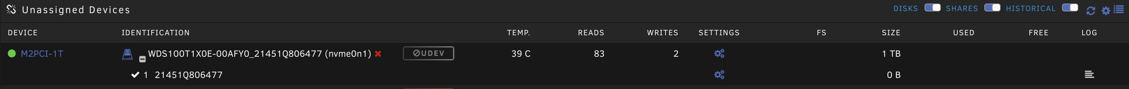

Hi I added a 1 TB NVMe in a PCIe to M.2 adapter to my Unraid Server. I managed to do "clear" and then "format". However, the result is this and I cannot access the device: Any recommendation what may be wrong here? THX! daNick
M.2 SSD in PCIe Adapter - ØUDEV Error (?)

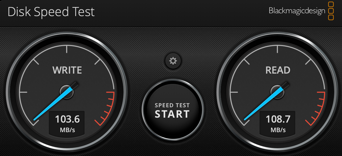

Hi My Macbook Pro M1 (latest MacOs) has speed issues... the usual ones. What I wonder: Using Blackmagic Disc Speed Test (to a share on Unraid), I get the below. Network is 1 Gig. Is my understanding correct that this means my MacBook can access the Unraid at full speed and writing also works in principle, so any issues shouldnt be on physical layer or write speed to disc, but should be a matter of the protocol / SMB layer? Thx for your opinion, I just would like to make sure I go from a solid basis here daNick
